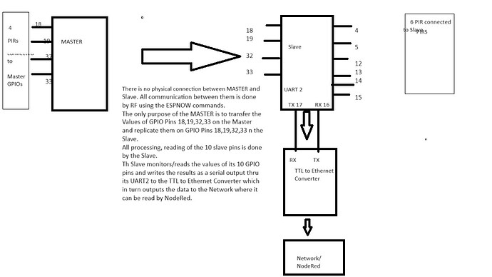

The project is a real life application and I started working on it during covid, gave up and recently picked it up again.
For my project the "Buttons" are room presence sensors, which have a normally open relay output.
Walk in the room, sensor activates, relay closes and stays closed for as long as its activated and goes off around ten minutes after leaving the room. Like a single long press button which gets pressed once and doesn't matter what happens when button is released?
The added complication is that these PIR presence sensors are ten in number and are located in two parts of the building, 4 in one place and 6 in another.
So I'm using 2 ESP32s which communicate using ESPNOW , and the hardware is quite straight forward.
The Master has 4 inputs
GPIO PINS 32 33 18 19 each to GND when switched by room occupancy sensor
and the Slave has 6.
GPIO PINS 4 5 12 13 14 15 to GND when switched by room occupancy sensor
All activations are collected by the Slave which uses serial2.println to send the relevent string to my network using the UART 2 of the slave via a Waveshare UART TTL to ETHERNET converter.
GPIO PIN 16 (RX) to TX on Waveshare Uart to Ethernet module
GPIO PIN 17 (TX) to RX on Waveshare Uart to Ethernet module
2-Channel UART to Ethernet Converter (CH9121) | The Pi Hut
These TTL strings are read by NODERED which creates actions like "switch lamp on" etc
I have cobbled together the Master and Slave codes as below and it sort of works although the Serial output from the Uart is a bit slow and temperamental (if I watch from the inbuilt serial monitor it's a much faster response)
I think this may be to do with the order I have things happening in the code.
Ive tried to study the arrays used in the code to send button data from the master to the Slave but still need to improve my understanding of arrays and pointers.
Hope this is enough for you to look at!
Her is the full code for review

Here is a block diagram
I thought it was the simplest solution for the Master to send the state of GPIO pins 18,19,32,33 to the slave and then process the state of the 10 slave pins.

Yes. I'm in transit and may be awhile before I can look closer, but just now I wonder why you need the button library at all.
The PIRs do not bounce and I believe they stay active for an adjustable (or relatively long fixed) period.
Therefor Barbara, now it's typing what I'm saying here stop that
Therefore, all you need is "state change detection", a simple matter of keeping track of the sensor value, and when it goes from not active to active, the so called edge of the signal, you issue your text on up to NODERED.
