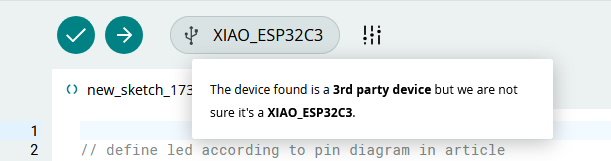

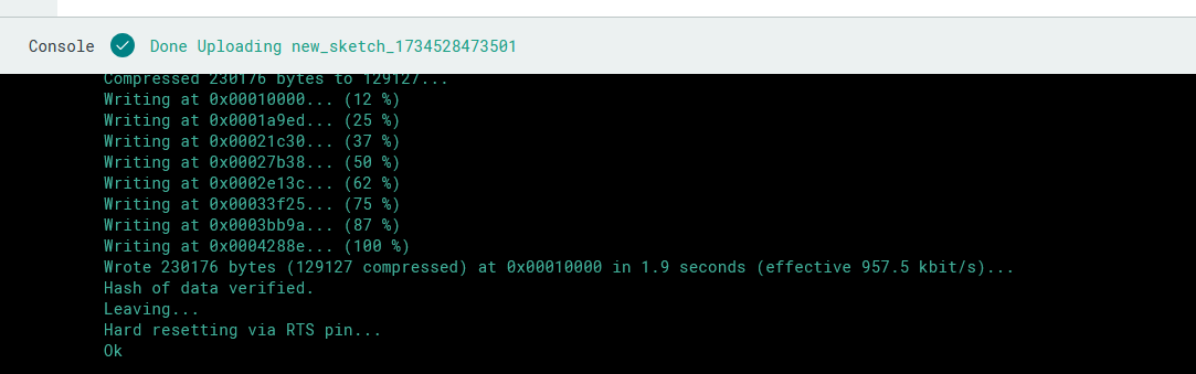

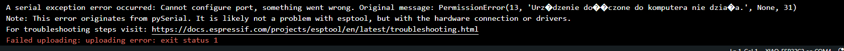

I’m also able to upload code via Arduino Cloud, but I cannot do it locally. When I try to upload code locally, I get the error: "Failed uploading: uploading error: exit status 1."

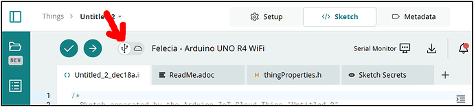

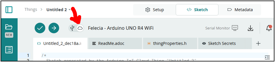

Is you project an Arduino Cloud IoT Thing, or a non-IoT sketch?
If it is an Arduino Cloud IoT project, when you upload via Arduino Cloud, are you using the Arduino Cloud IoT OTA uploads feature, as controlled by having the switch on the toolbar in the position over the cloud icon:
Or is the USB logo icon selected instead:
By the second option.
But if im want do it by IDE
I'm going to ask you to provide the full verbose output from an upload attempt.
