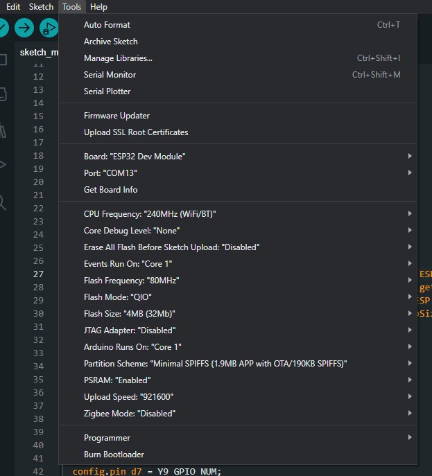

It seems that data doesn't store in the psram directly,it store in the internal ram first,and move the data from internal ram to psram,is it correct?
if yes,is there a way can just store data in psram,not store in the internal ram first?
Hi @lemonsamon ,
Welcome to the forum..
Did you enable the psram, it's in the tools menu??

here's a pic of my settings..
using a cheap aithinker..
~q

Look at my pic..
Like I said the git is a bit messed doesn't list the dev release version properly..
i'm using 3.0.0.-alpha 3..
but yeah, could try last stable 17..
no not broken, probably just a bug..
~q
