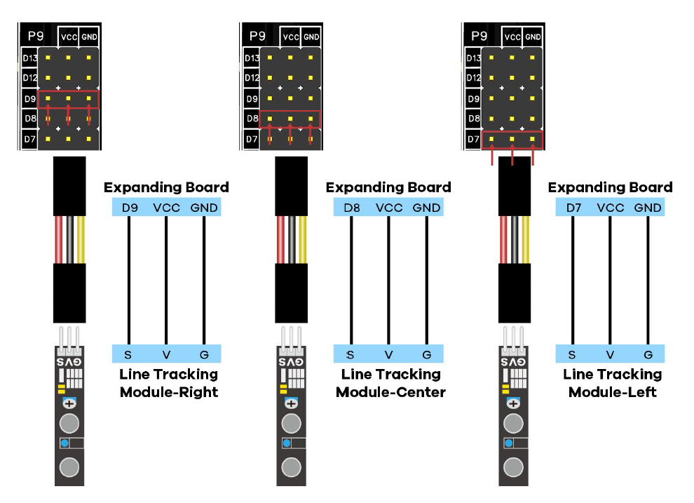

Also, this is the schematic of the robot car:
For line tracking:
For the Ultrasonic, ESP32 CAM, and the line tracking
