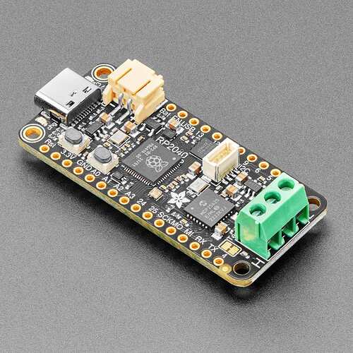

if you still wish to use the Raspberry Pi pico with Canbus there is the Adafruit PiCowbell CAN Bus for Pico
or Adafruit RP2040 CAN Bus Feather with MCP2515 CAN Controller

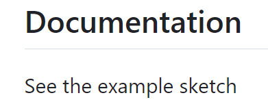

I found this library
I simply quote the documentation and leave it up to you to make up your own opinion about this documentation
and this is the example-sketch

is the bus terminated correctly with 120ohm resistors?
what CAN transciever are you using?
I have ordered one of the Adafruit RP2040 CAN Bus Feather with MCP2515 CAN Controller
yes
too much hasseling with the Rpico-PIO-version.
if you need to use a RP2040 I would move to a Adafruit RP2040 CAN Bus Feather with MCP2515 CAN Controller - all on the one PCB - no problems with different logic levels, wires giving poor connections, etc
otherwise use an ESP32 and the ESP32-TWAI-CAN library with a CAN transciver
update using adafruit-rp2040-can-bus-feather
notes:
  1. select board Adafruit Feather RP2040 CAN (to get correct SPI pinout etc)
  2. crystal is 16MHz
  3. GPIO19 - CAN Chip Select pin in Arduino with PIN_CAN_CS.
  4. GPIO22 - CAN Interrupt pin in Arduino with PIN_CAN_INTERRUPT.
updated code:
// RP2040 RPi Pico CAN Receive Example - note added INPUT_PULLUP to CAN0_INT
// Note for RP2040_CAN select board Adafruit Feather RP2040 CAN
#include <mcp_can.h>
#include <SPI.h>
long unsigned int rxId;
unsigned char len = 0;
unsigned char rxBuf[8];
char msgString[128];  // Array to store serial string
#define CAN0_INT PIN_CAN_INTERRUPT  // for RP2040_CAN MCP2515
MCP_CAN CAN0(PIN_CAN_CS);    //
  delay(2000);
  Serial.println("\n\nRP2040 CAN (MCP2515 onboard) Send/Receive test - MCP2515 Initialize");
  // Initialize MCP2515 baudrate of 250kb/s and the masks and filters disabled.
  //  check crystal frequency!!
  // e.g. Canbus shield/RP2040_CAN is 16MHz MCP2515 is 8MHz
  if (CAN0.begin(MCP_ANY, CAN_250KBPS, MCP_16MHZ) == CAN_OK)
    Serial.println("CAN Receive - MCP2515 Initialized Successfully!");
    Serial.println("Error Initializing MCP2515...");
  CAN0.setMode(MCP_NORMAL);         // Set operation mode to normal so the MCP2515 sends acks to received data.
  pinMode(CAN0_INT, INPUT_PULLUP);  // Configuring pin for /INT input *** added PULLUP ***
  Serial.println("MCP2515 Library CAN Send/Receive Example\n enter space to send a frame");
  // check for data received
  if (!digitalRead(CAN0_INT))  // If CAN0_INT pin is low, read receive buffer
    CAN0.readMsgBuf(&rxId, &len, rxBuf);    // Read data: len = data length, buf = data byte(s)
    if ((rxId & 0x80000000) == 0x80000000)  // Determine if ID is standard (11 bits) or extended (29 bits)
      sprintf(msgString, "Extended ID: 0x%.8lX  DLC: %1d  Data:", (rxId & 0x1FFFFFFF), len);
      sprintf(msgString, "Standard ID: 0x%.3lX       DLC: %1d  Data: ", rxId, len);
    Serial.print(msgString);
    if ((rxId & 0x40000000) == 0x40000000) {  // Determine if message is a remote request frame.
      sprintf(msgString, " REMOTE REQUEST FRAME");
      for (byte i = 0; i < len; i++) {
        sprintf(msgString, "0x%.2X ", rxBuf[i]);
      Serial.print((char *)&rxBuf + 1);
    Serial.println();
  // transmit data when space entered on keyboard
  if (Serial.available()) {
    if (Serial.read() != ' ') return;
    static byte data[8] = { 0x00, 'R', 'P', 'i', 'C', 'A', 'N', 0};
    for (byte i = 0; i < 8; i++) {
      sprintf(msgString, " 0x%.2X", data[i]);
    // send data:  ID = 0x100, Standard CAN Frame, Data length = 8 bytes, 'data' = array of data bytes to send
    byte sndStat = CAN0.sendMsgBuf(0x100, 0, 8, data);
    if (sndStat == CAN_OK) {
      Serial.println(" Message Sent Successfully!");
      Serial.println(" Error Sending Message...");
    data[0]++;  // increment first byte of data
serial monitor output
Entering Configuration Mode Successful!
Setting Baudrate Successful!
 0x00 0x52 0x50 0x69 0x43 0x41 0x4E 0x00 Message Sent Successfully!
 0x01 0x52 0x50 0x69 0x43 0x41 0x4E 0x00 Message Sent Successfully!
Standard ID: 0x100       DLC: 8  Data: 0x0A 0x4D 0x45 0x47 0x41 0x00 0x07 0x08 MEGA
Standard ID: 0x088       DLC: 8  Data: 0x11 0x50 0x49 0x43 0x32 0x34 0x00 0x00 PIC24
 0x02 0x52 0x50 0x69 0x43 0x41 0x4E 0x00 Message Sent Successfully!
 0x03 0x52 0x50 0x69 0x43 0x41 0x4E 0x00 Message Sent Successfully!
Extended ID: 0x07788888  DLC: 8  Data:0x11 0x50 0x49 0x43 0x32 0x34 0x00 0x00 PIC24
Standard ID: 0x100       DLC: 8  Data: 0x0B 0x4D 0x45 0x47 0x41 0x00 0x07 0x08 MEGA
Thank you so much for your provided code. After days of failing, I finally got my CAN-Bus working on my ESP32-S3 with the SNHVD230 Transceiver.
You're a king
