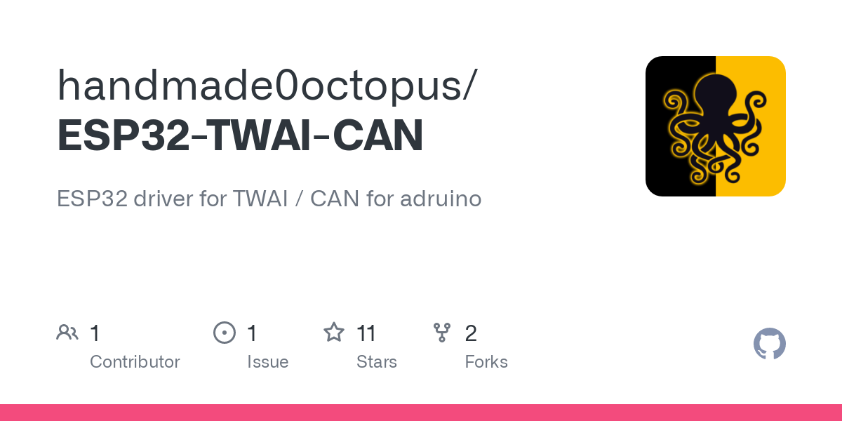

I did the same and tried multiple libraries.
Same problems some did not compile, some did not work
finally user @horace pointed me to this library
ESP32-TWAI-CAN library
There is only one rather poor example-code for this library which is somehow specialised to request the coolant-temperature of a car if you connect the ESP32 to the ODB2-socket in the car.
Though I don't got a car laying around on my table ;-) I started to modify the demo-code to be more informative and to be more general to better explain the principle how to use this library
So I finally have a working demo-code that demonstrates the basic principle.

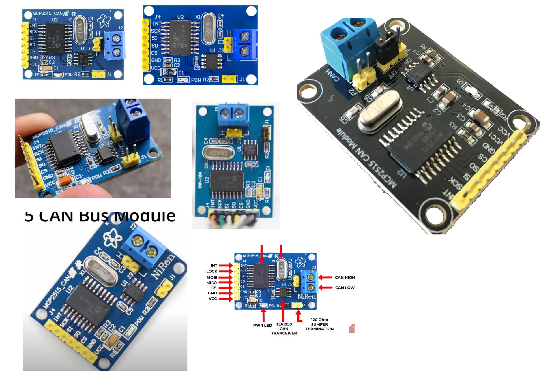

ATTENTION ! 8 MHz-CAN-Bus modules require changing the library-sourcecode
If you use a MCP2515-can-bus module with a 8 MHz chrystal the source-code of the library must be changed
Most of these 8 MHz modules look like this
The chrystal is this component

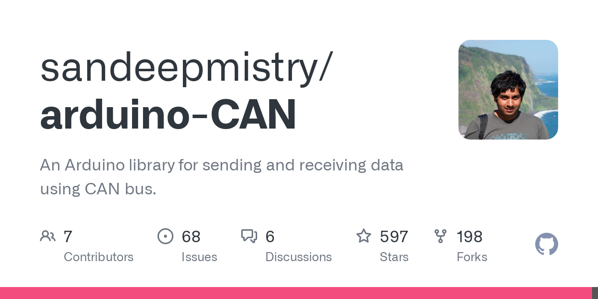

Inside the library-file MCP2515.h comment / uncomment that line that matches the chystal-frequency on your MCP2515-module
A smart improvement that would take away this beginner-trap would be to modify the library to have this chrystal-frequency as a parameter in the constructor
// Copyright (c) Sandeep Mistry. All rights reserved.
// Licensed under the MIT license. See LICENSE file in the project root for full license information.
#ifndef ARDUINO_ARCH_ESP32
#ifndef MCP2515_H
#define MCP2515_H
#include <SPI.h>
#include "CANController.h"
//define MCP2515_DEFAULT_CLOCK_FREQUENCY 16e6 // defining a 16 MHz chrystal
#define MCP2515_DEFAULT_CLOCK_FREQUENCY 8e6   // defining a  8 MHz chrystal

That is dependent on the crystal used. I think you may have a 16 MHz on the board and your code is for 8 MHz.
You do not have the MCP2515 module you indicated. The module shown is the CAN bus transceiver which takes the data from the CAN controller and translates them to the physical CAN bus levels which you stated you use.
From what I understand the RP2040 does not have a dedicated CAN peripheral on chip. I understand that Kevin ??? wrote code for the RP2040's PIO engine that can receive and send CAN packets. I will take a SWAG since I do not know or have the part suggest checking the clock divider for the PIO engine that is doing the CAN.
The library you are using with the Uno has 16MHz hard coded as the crystal speed. This is probably because most shields ship with a 16MHz crystal.
Niren style adaptors usually ship with an 8MHz crystal, therefore you need to modify the library to suit. (These half speed adaptors work OK, but cannot do CAN bus speeds above 500kBPS.)

it's unclear what library exactly you are using for the UNO code
if it is
name=CAN
version=0.3.1
author=Sandeep Mistry sandeep.mistry@gmail.com
there is a setter function:
void setClockFrequency(long clockFrequency);
to be as short as you:
I tried
  CAN.setClockFrequency(8000000);
but with this modification of the receiver-code did not work.
I don't see what library you are using.
I told you what I have used.
my src/MCP2515.h doesn't have a line to "uncomment"
it looks like following
#ifndef MCP2515_H
#define MCP2515_H
#include <SPI.h>
#define MCP2515_DEFAULT_CLOCK_FREQUENCY 16e6
so what you are using?
"did not work" means what?
compiler throws what error?
Baudrate remains unchanged?
Baudrate is set to any value <> 500.000?

As the receiver I use an Arduino Uno in combination with a NiRen-style
MCP2515 TJA1050 which looks like that
which has a 8 MHz chrystal
[details = CAN.h and MCP2515-library]

ESP32-S3-code is set to real 500 kbps
in combination with receiver-code using default chrystal-frequency set to 16 MHz
and then using in the Uno MCP2515-receiver-code
  CAN.setClockFrequency(8000000); // 8 MHz
result: communication did not work at all.
The can bus showed no bit-banging at all on the oscilloscope
flat lines on CAN-LOW and CAN-HIG
changing the ESP32-S3 sender-code to use CAN_Speed / 2 = 250 kbs
  if (ESP32Can.begin(ESP32Can.convertSpeed(CAN_Speed / 2), CAN_TX, CAN_RX, 10, 10) ) {
    Serial.println("CAN bus started successfully!");
  else {
    Serial.println("starting CAN bus failed!");
combined
with MCP2515.h using source-constant
but in reality the niRen MCP2515-module is using an 8 MHz-chrystal
makes the communication work. Very plausible.
Code calculates with 16 Mhz
in reality using a clock of 8 MHz which is the half of 16 MHz
configuring Uno-MCP2515-receiver-code to use 500 kbs results in 250 kbs
which matches the ESP32-S3-sender-code which uses 250 kBs too.
it does not work with adding CAN.setClockFrequency(8000000); // 8 MHz
If I add in the Uno-MCP2515-receiver-code the line
in combination with ESP32-S3-sender-code using 500 kps
  int CAN_Speed = 500;
  Serial.print("ESP32Can.begin(ESP32Can.convertSpeed(");
  Serial.print(CAN_Speed);
  Serial.print("), CAN_TX=");
  Serial.print(CAN_TX);
  Serial.print(", CAN_RX=");
  Serial.print(CAN_RX);
  Serial.print(", 10, 10) )");
  Serial.println();
  if (ESP32Can.begin(ESP32Can.convertSpeed(CAN_Speed), CAN_TX, CAN_RX, 10, 10) ) {
it does not work regardless of using
//or
define MCP2515_DEFAULT_CLOCK_FREQUENCY 8e6 // defining a 8MHz chrystal
that is the reason why I posted
that the in the Uno MCP2515-library
MCP2515_DEFAULT_CLOCK_FREQUENCY must be adjusted to 8e6
are you using this library on the UNO?!?
You didn't show how and where you have put the line
but looking at the can bus source code it seems it has to be called before you call the .begin() member function as the setter only sets a member variable _clockFrequency while the .begin() uses the _clockFrequency and adopts some parameters.
first set the clock frequency
than call begin
report what's happening.
If it is still not working, show your updated code.
I would have thought it must be the opposite order
