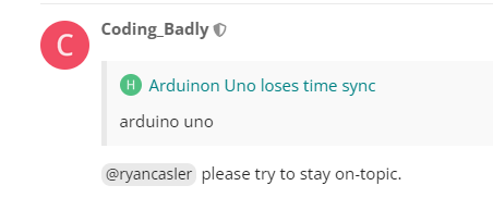

@ryancasler please try to stay on-topic.
The title of the thread is ESP32 Clock Accuracy. So, what's the topic?
The accuracy of the ESP32 clock so where does the Uno come into it ?
Then why???
This snippet is split from the original thread. You'll notice the link in the first post with the "RE". I foolish assumed that was an obvious indication that this had been taken from another thread. I guess next time I'll include something like this...
THE OFF-TOPIC JUNK BELOW WAS SPLIT FROM THE ORIGINAL THREAD JUST IN CASE YOU'RE CONFUSED ABOUT THE LINK AT THE VERY TOP
The topic there, the topic of concern, the topic you and @anon57585045 failed to stay on, was "Arduino Uno".
I kept this snippet in case you and @anon57585045 wanted to continue discussing the ESP32 clock. I assume its accuracy is of interest to the forum at large. But it is of no interest to hassaanzaheer.
Sorry, I simply didn't notice the change of subject in the original thread.
