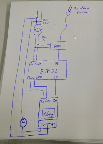

I'm working on a simple project of plant watering.
My ESP32 controls a 3.3V relay that is driving a small 230V pump.
The problem is that the ESP sometimes crashes when driving off the relay.
This problem only comes when the power stage of the relay is connected to 230VAC and the pump
When the project is running without the pump, there is no problem. The relay works fine
When the problem happened, my debug console is showing a lot of incomprehensible characters. See attachement
Never see that before...
I checked the output current of the ESP's output pin : 0.54mA (i think its ok)
I checked all my wiring. You can find it in attachement.
For the test, i created a small program that is driving on and off the relay alternatively by 5s. Even with this small program, the problem is happening. Here is the code :

Anyone knows this kind of error ?
Do i have wiring problem or electrical issue ?
You must have if the pump's presence is the cause. What kind of 5v Power Supply are you using ? Seeing that the relay appears to be of the opto-coupler driven kind (given the 3 lines, one of which for control) that can hardly be the issue, although the relay still draws considerable current on the 3.3v rail. It would appear as if the 5v power supply has a temporari difficulty to supply the required current the moment that the pump turns on. I would add a fair size (100uF) Capacitor on the 5v Rail, and also another smaller one (10uF) on the 3.3v rail.
Pumps can draw a lot of current, though normally speaking AC-mains should not be very sensitive to those kind of things, so it is a bit of an anomaly. Does it still happen when the pump is connected to a power socket a few meters away from the the power supply ? Other possibility is interference, how far away from the pump did you put the ESP ?

Powering a 3.3volt relay module (~150mA) from the 3.3volt supply is a really bad idea.
The 3.3volt regulator, and it's heatsink area, is not designed to do this.
Should have seen that with my first reply.
Get a 5volt relay module, and power it from the 5volt/raw/V-in/USB pin of the ESP32 module.
And what is that ADC block for the moisture sensor.
Shouldn't that be powered from the 3.3volt pin.
Bad idea to connect 5volt logic to an ESP32 I/O.
Leo..

Ah well, those are not Opt-coupler driven, but transistor driven. Yes it does have a fly-back diode, but i would expect it to draw a considerable amount of current, and although the nodeMCU probably can power it
the regulator can take up to 600mA and the heatsink of a nodeMCU is considerable, still i would prefer to power the relay separately using a 3.3v TO-220 package regulator would do, and i would for sure add an extra capacitor on the 3.3v rail
I already tried to put a capacitor (1500uF/6.3V) on the 5v rail, but no result
then just a 100uF on the 3.3v rail, and try to give a bit more room on the voltage rating, 20% is not a lot.
Because of the 3v3 output of the ESP that cannot drive a 5v relay
That is not true ! even the transistor driven relays can be used with lower voltage logic (in fact more so than the opto-coupler driven ones because the value of the current limiting resistor is less relevant, and won't need modification)
Anyway, if there are 5v spikes that does clarify the issue for me, the nodMCu's onboard regulator will have to dissipate more heat at higher input voltages, and you are probably already stretching it to it's limits, and the crashes are caused by the overheat protection of the regulator kicking in.
I'd say, the best and cheapest solution would be a separate 3.3v regulator (TO-220) that gets' it's power from the 5v power supply with another capacitor. Or just get a 5v relay (you may even be able to run the 3.3v one of 5v if you add a small value high wattage resistor in line with vcc, for that you would need to measure it's resistance and do some calculating)
