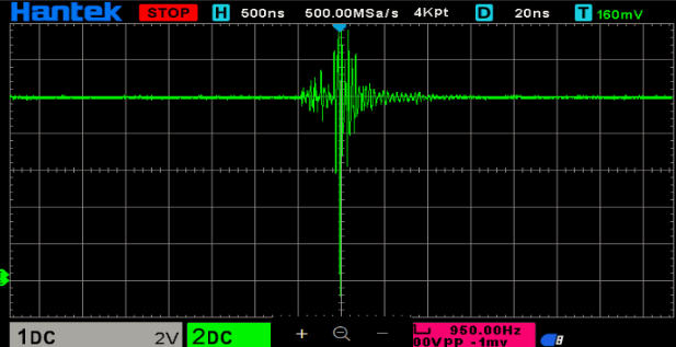

can you provide a schematic showing the wiring and power supplies?
in particular you could be having power supply problems
Waveform on MCU 5v
Thank you for your solution

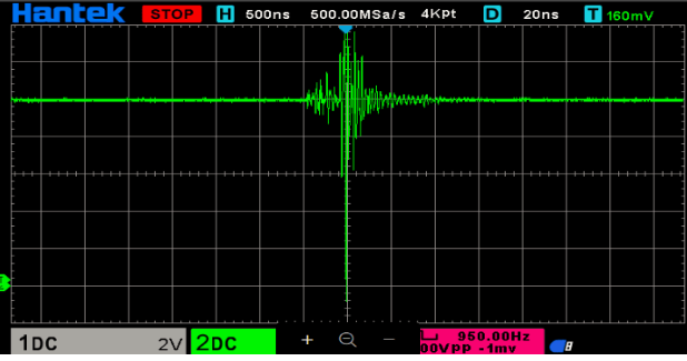

I'm working on a 0-100V system. I've converted the 0-100V input to a 14V signal, and then further to a 5V signal. The 5V signal is used to power the RTC and SD card. Here's the circuit diagram for the 14V conversion:
waveform on 14v
For 5v
Waveform on 5v
It looks like the 10uf power supply output capacitor has too much reactance to filter out the high frequency switching noise. Try adding a 1nf ceramic capacitor across each 10uf capacitor.
