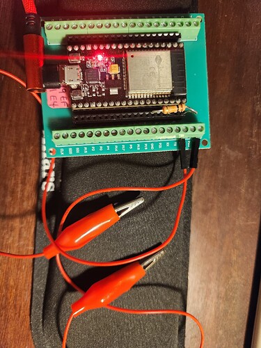

Wiring is using a 10Kohm resistor from the input (22) to ground. I have metered all connections. The input goes to 1 ohm with the alligator clips connected.
wiring pic:
Try pinMode(switchPin, INPUT_PULLUP);
Wire the switch from the input pin to GND, a LOW means switch is closed.
so you have a 10k between 22 and GND,
and your aligator clips switch is also 22 and GND??
if my understanding is correct, then the state will definitely not change.
connect the 10k to 3v3 instead, or remove it and use internal pull up as LarryD suggests.

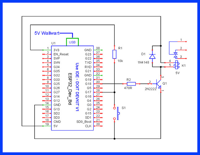

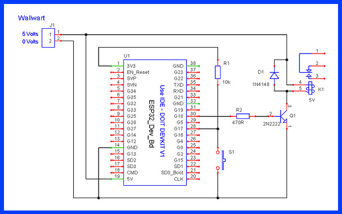

Well I now realize I am in violation of ESP wiring prootcol. I have been using VIN [+5V] on the 30 pin ESP32 to not only drive a digital input w/ external 10K resistor but also to energize one of those small black AGT icecube relays via a 2N2222. Are we supposed to find a 3v coil relay to use with an ESP. I know with a wall wart providing the power to an ESP through the USB port there is the +5v present at VIN. Is this something being done that is not "kosher?"
  • The ESP32 output drives a NPN transistor (2N2222) whose emitter is connected to GND.
  • A relay coil connects to the transistor collector then to your relay supply voltage, can be 5v, 12v, 24v …
We put a reverse biased kickback diode across the relay coil (1N4148).
When the ESP32 output goes HIGH (3V3), the transistor turns on and the relay picks (energizes).
The label 12v, can be 5v or 24v etc., but must match the relay coil rating.

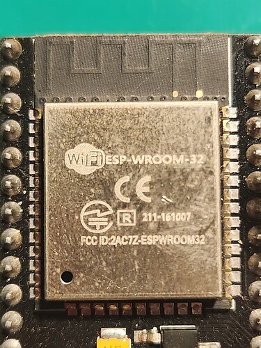

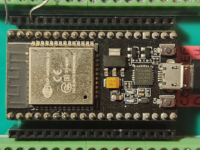

When you say ESP32, which one are you using ?
Take a picture of the controller so we can see what it looks like.
:thinking:
It is the WROOM 38 pin model. I believe it is the ESP DROVER (sp?) option from the IDE processor select listing. I do not have the IDE up right now. That one seems to work for me. I used the shorter ESP WROOM (30 pin) on an earlier project.
Please zoom out so we can see the whole PCB module.
here ya go:

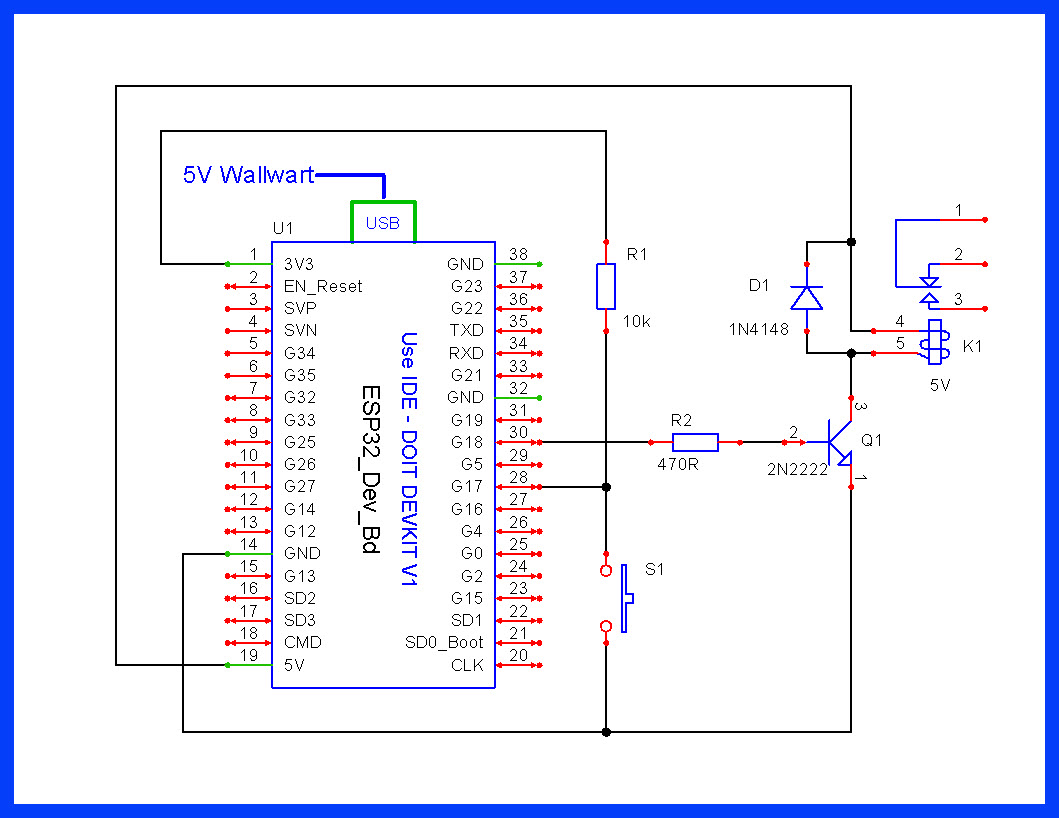

This is what we are looking for in connections to a relay and switch.
  • Your pin locations might be different from mine.
If it was me, I would connect the 5V wallwart to the modules 5V pin, and the wallwart 0V to the modules GND pin.
i.e. Don't use the wallwart into the USB plug
See schematic below:
