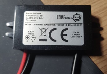

Can you show the specs of the converter and a photo of it, please?

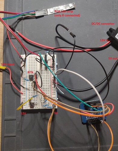

Also a photo of how you have everything wired together, please.

I don't have any additional specs from the DC/DC other than the ones from the picture below.
Please ignore the second (unlabeled) button on the breadboard, it was used for testing the 12V-measuring functionality. 12V rail on the left, 5V on the right, both share the same GND (connected at the top). The ESP unfortunately can't sit on the breadboard directly due to its two rows of headers per side. I wanted to not route 12V through the breadboard, but then needed it too often to not do so.
Hope the picture is somewhat identifiable.

Thanks; please do that (the blink testing). Note that this could be something as simple as a dodgy breadboard connection. The DC-DC converter itself looks fine in terms of specs, but the wire sticking into the breadboard...well, I'm not too sure of that. Run the blink test and especially try to give the breadboard a nudge as it runs; if you see the rhythm change or it misses a beat, it has likely reset. You can further monitor this by having a counter increment and output that to Serial so you can see if/when the counter has reset.
Having not had good experiences trying to power any ESP microntroller via a breadboard,
