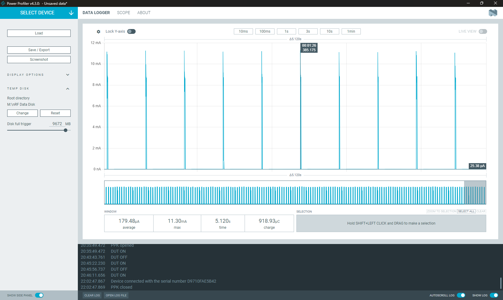

GitHub project "EoRa PI Foundation" receiver has 175 µA average current consumption using SX1262 LoRa Duty Cycle and Deep Sleep. Current measurement images; done with
Duty cycle = ~1.4% of the time listening (11 mA spike, lasting 9.91 mS), ~98.6% of the time deep sleep (Baseline current 25.38 µA).
