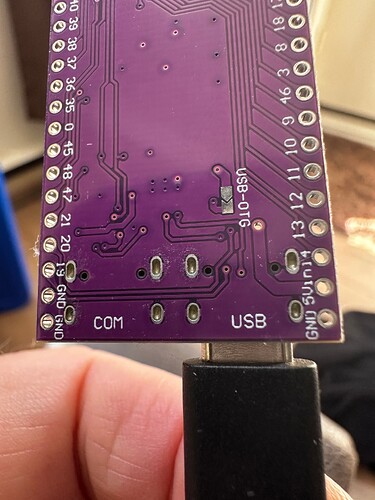

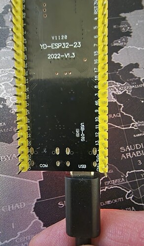

using ESP32S3 Dev Module profile on a COM port via the USB connector on the board
Board (marked USB, not COM on the back of the board, using COM fails the upload): YD-ESP332-23 v1.3

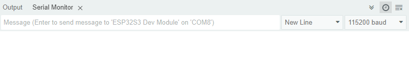

Serial Monitor running on 115200 baud is blank
Why does it not print "Testing" continuously?

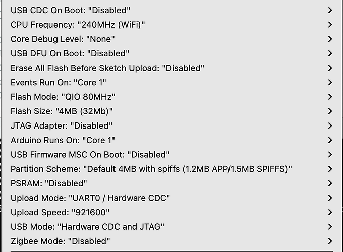

Hi @der_leviathan_2025. A fairly unique thing about the boards that use the microcontrollers of the ESP32 family with native USB capability (as is the case with your board) is that they are typically configured to disable the use of their USB CDC serial port in the sketch by default.
That default disabled configuration is appropriate when your sketch doesn't use the serial port, but in cases where you do need it (such as when your sketch calls Serial.println, etc.), then it is necessary to configure the board so that the port will be enabled. Fortunately this is quite easy since the ESP32 boards platform developers configured the board definition to produce a custom board options menu you can use to enable or disable the port as needed via the Arduino IDE user interface.
Please try this:
  1. Select Tools > USB CDC On Boot > Enabled from the Arduino IDE menus.
  2. Upload the sketch to your board again, just as you did before.
Now check the Serial Monitor. Hopefully you will now see the expected output from the board there.

I've changed the USB CDC On Boot to Enabled but unfortunately, after a re-upload, the Serial Monitor still does not show any messages.
On my quest to get this up and running, I've tried multiple things, so I hope I have not changed any important settings :see_no_evil:
I hope the screen capture above might spark further ideas.

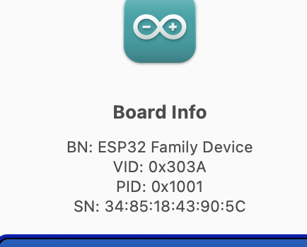

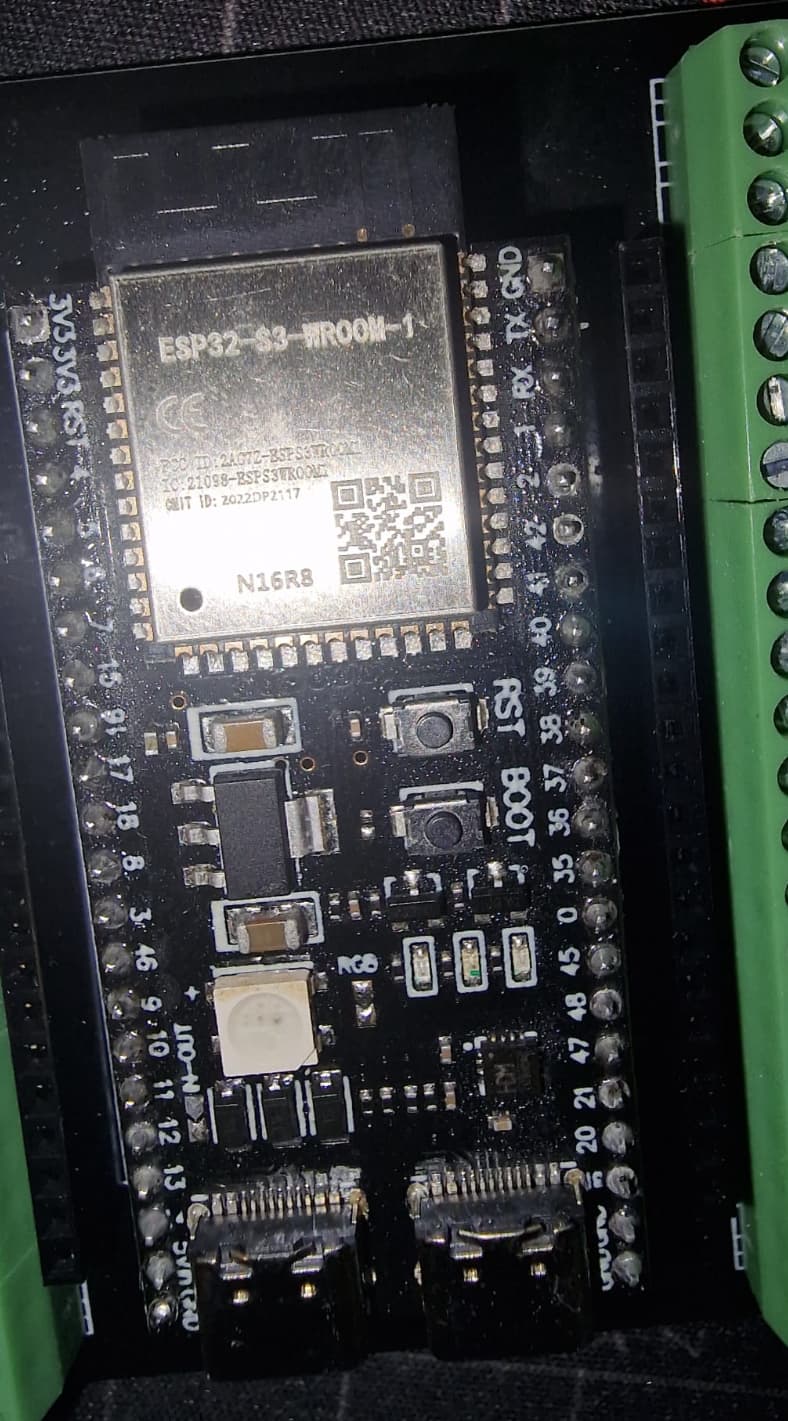

I just pulled out one of my esp32-s3 boards and uploaded the blink sketch. I am NOT including a video of the blink running as vids are not allowed but if you want proof, I can figure something out to get it to you, screen shots of Tools and Board Data plus photos front and back of my board.
Ill have a look into this in a little while. Which blink sketch did you use? Can you post the code here, please? :man_bowing:
It's the IDE basic sample.
I then tried your original sketch and NO serial output. I then tried my default sketch, which also did nothing. I then added a print followed by a 1-second delay and could see the red led blinking at 1 sec interval. I then changed to a 5-second delay, and the red LED now blinks at 5 5-second intervals.
Something is preventing the serial output from showing up. I have to go out but maybe someone will remember what the secret is.
Thank you @sonofcy
I've tried the Blink default sketch from Arduino (File -> Examples -> 01.Basics -> Blink) but unfortunately, after the upload the onboard LED does not blink as expected :frowning:
Ok, take the same pictures and screen grabs as I did so we can see what the heck the difference is.

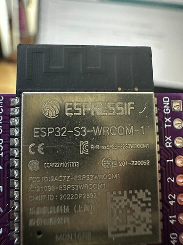

Here we go

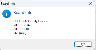

I've tried both enabling and disabling USB CDC On Boot
Funny enough I do not get a serial number back
I am going to make a wild guess and say the no serial number means a clone or fake board.
After purchasing the board, i found out exactly that, it is a cloned board spattered all over Amazon :unamused:
Let me see if i can get a genuine board online and maybe that will give me the desired result
