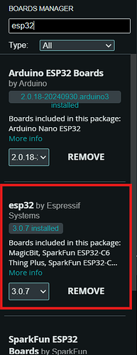

Which version of the ESP32 board package are you using?
Espressif ESP32 board support, v3.0.5 (latest released). Where are you getting 3.0.7?

Well, I am glad I checked, after the last Arduino IDE update, my URLs got completely cleared! Added it back and yes, 3.0.7 is the latest. I will test it and if it is fixed I will reply back.
Issue still active with the latest release. So must be an ESP32 issue.
