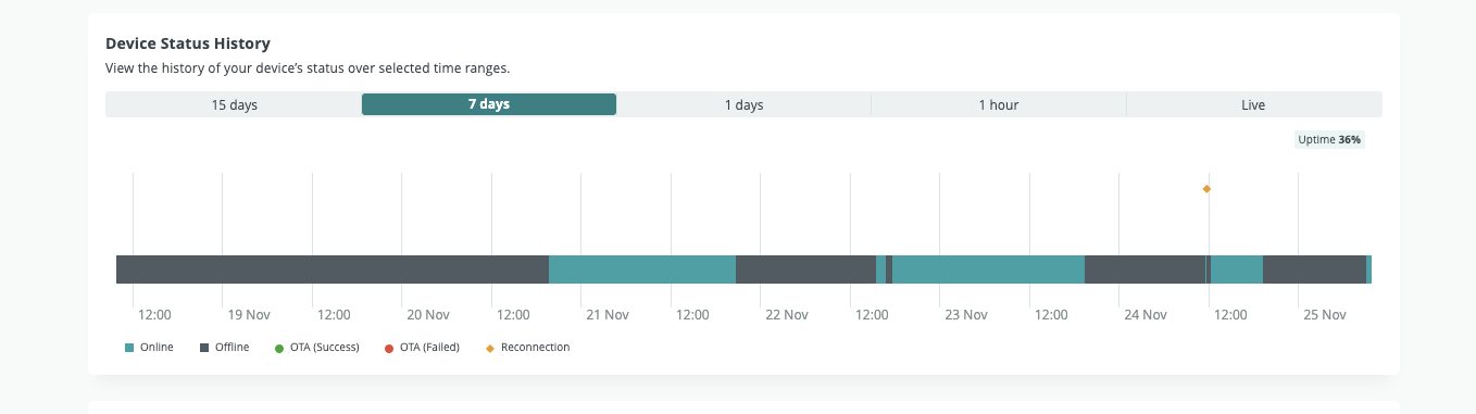

ESP32 shows as offline when it clearly isn't
Hey guys! Recently I migrated my pool controller from a Wemos d1 (ESP8266 based) to an ESP32 devkit, because I wanted to add a couple more relays and not have to deal with the intricacies of some pins during bootup. The issue I'm having is that the device will show as online for a few hours after boot and then randomly go offline forever until reset and it stops tracking cloud variables. When this happens, the device is still perfectly pingable, so I know it's not out of wifi coverage. In fact, I can kick the device from a hotspot and it'll happily connect to another and resume being pinged, but still be offline in the Arduino cloud devices list. Yesterday I added code to make the onboard LED blink all the time, so I could verify that the loop is still running correctly. The device still works to the point I can do OTA uploads using the ArduinoOTA library when it's in this broken state and they work perfectly too, basically the only thing that stops working is the syncing of cloud variables. What could be causing this?
Here's the thing's code FWIW
