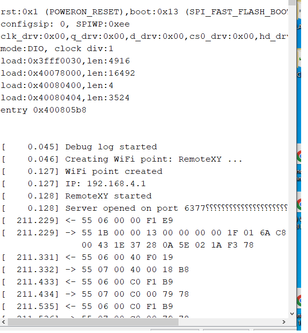

Hi @tom321. I see that the RemoteXY library has a debug output feature:
https://remotexy.com/en/help/code/review/#:~:text=commented%20line%20//-,%23define%20REMOTEXY__DEBUGLOG,-.%20If%20you%20uncomment
The example also contains a commented line //#define REMOTEXY__DEBUGLOG . If you uncomment it, the RemoteXY.h library will be configured to output debug information to the Serial port at a speed of 115200.
The debug output might give some insight into what is going wrong. Try this:
  1. Add the following line to the top of your sketch:
  2. Comment out these lines in your sketch:
    Serial.print("   V = ");
    Serial.println(analogRead(sensorPin));
    ⓘ The reason for doing this is that, since this code is configured to print to Serial on every single execution of loop, it will flood the Serial Monitor with output and make it difficult to see the debug output from the RemoteXY library.
  3. If it is not already open, open the Arduino IDE Serial Monitor.
  4. Upload the sketch to the ESP32 board.
Then watch Serial Monitor for any useful information.

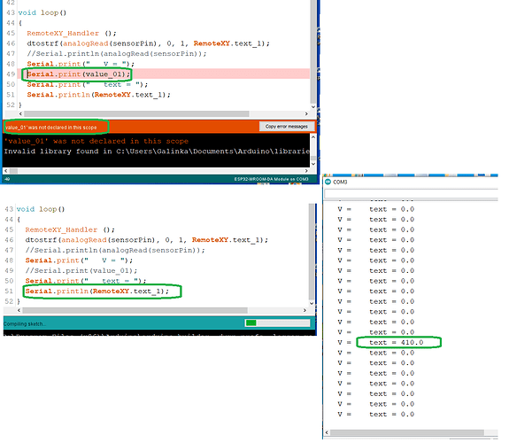

I don't use RemoteXY but I see you print to the Serial monitor by directly reading the value again instead of looking at the actual value you stored with dtostrf().
try printing RemoteXY.text_1 instead to see what was set.
Also what does not work - value_01 or text_1 ?
Sometime on serial monitor are some numbers, but on
iPhone is all the time zero 0

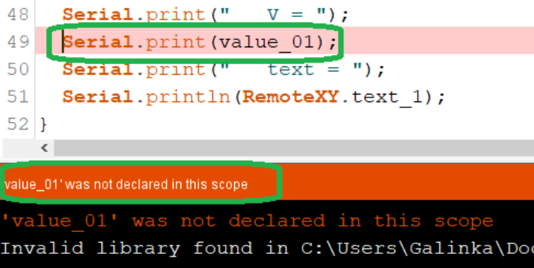

for this error
you need to print the attribute of your structure
Serial.print(RemoteXY.value_01);
Exactly as you did for the text_1 attribute (weird names by the way - why not simply value and text) ?
Also if the values are integers, don't use dtostrf() - you can just use snprintf() or itoa() and the likes
