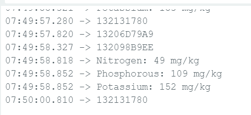

hello, can i ask how do i resolve this issue, and how can i connect the same pin in DE RE. thank you!!

Your results indicate you have do not have the RS485 connected.
You have Modbusmaster library included and you initialize sensor.begin, but you don't use it in you code.
What board you have? Esp32 default pins for Serial2 are 16/17.

im using MaxRS485 modbus, the modbus is giving a red light, so i thought its working
im using Dev Module, i just follows what the internet/chatgpt says, sorry im new to this so i dont really have idea :smiling_face_with_tear:
i search about npk sensor, i found some, but i cant see the replies in the post, thats why i decided to post, and im new to this so i dont really have idea about this, but i will keep looking, thanks for the effort, i really appreciate it :smiling_face:
i saw one of the post, you have reply in that post, i have the same type of item like the post, also tried the 5v pin, but the result is unrecognized characteristics.
12v power adapter for sensor and when i test it in sensor configuration, it gives me the value
so i thought that its the code thats not working
For normal Esp32, Serial2 has default pins 16/17.
If you want use those pins on Serial1, you need to define them:
SerialRS485.begin(9600, SERIAL_8N1, 16, 17);
Anyway, I suggest you to use Modbusmaster library code for your approach.

That screenshot is good news. It shows you a lot of information. You know for sure that your serial comms should be 9600 baud and that the device address is 1. You also know that the 3 parameters are in registers at addresses 1E, 1F and 20, and that the sensor is working from an electrical connection point of view.

Update guys, the npk sensor work now
12v power supply
TTL to RS485
Pin that works in esp32 dev module
GPIO26 RX
GPIO27 TX
3.3 v in esp32

Glad you got it working. Note that the readings returned by these NPK sensors are usually garbage.
However, the "values" returned are not quite right as the serial comms has a flaw. It's the same issue that lots of other NPK sensor code found on the web has as they all copy eachother.
Post back here if you would like an explanation.
u are using esp32, how can u use include softwareserial for this, i also facing problem that only get 255mg/kg value on it
A value of 255 is usually a sign that the serial interface is returning the value -1. This generally means that you are trying to read from the serial port when there is no data available.
