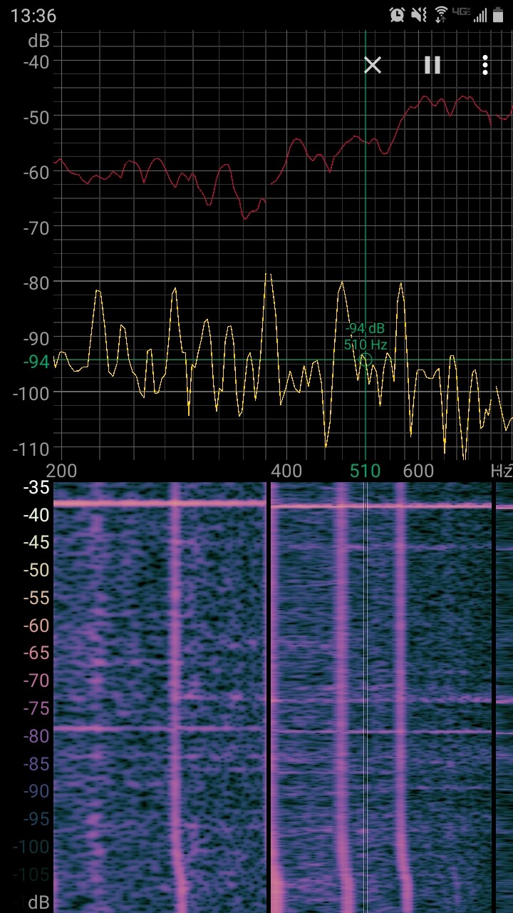

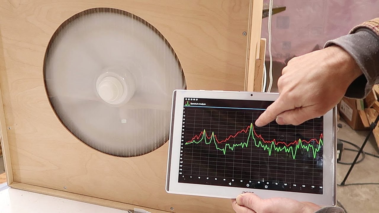

FREE Portable sound analyzer using smartphone demonstrated by Marhias Wandel.
That's a great idea, thanks!
This is a 10 year old Laptop fan.
