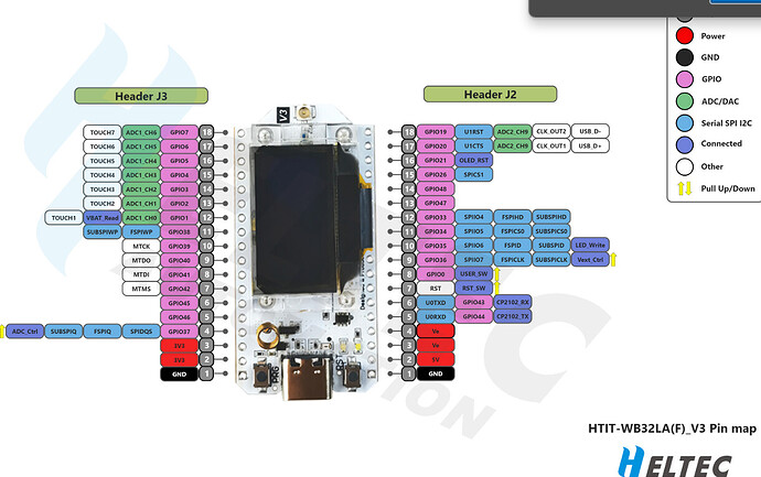

my setup is I am just connecting the heltec lora32 v3 to the SG90 Servo motor. There is a slight displacement from each rotation
the pinout for the esp32:
That confirms that you have a so called "continuous rotation servo" and cannot control its angle
