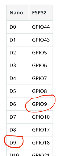

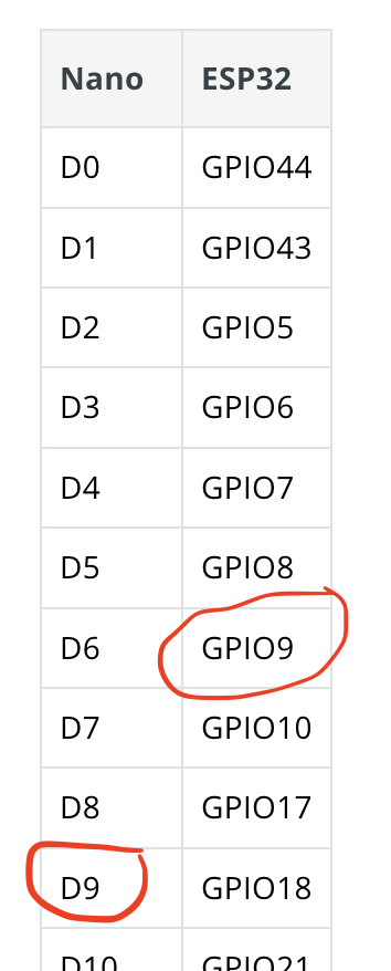

I think the library uses GPIO, so wire the board accordingly. If that works for ANY example I would think that means it is the right choice, but maybe some examples have been changed.
I would try the GPIO option first, and if that fails, try the Arduino option.
Try Sweep and PWMExample, but remember to move the wires to the matching pin.
Example, if your code has pin 9 then these are the two different pins to use for the two different modes

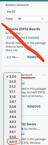

Sorry, I forgot that code is broken in the library, change your espresssif boards entry to 2.0.17 Here is the link, look for ledc
https://docs.espressif.com/projects/arduino-esp32/en/latest/migration_guides/2.x_to_3.0.html
