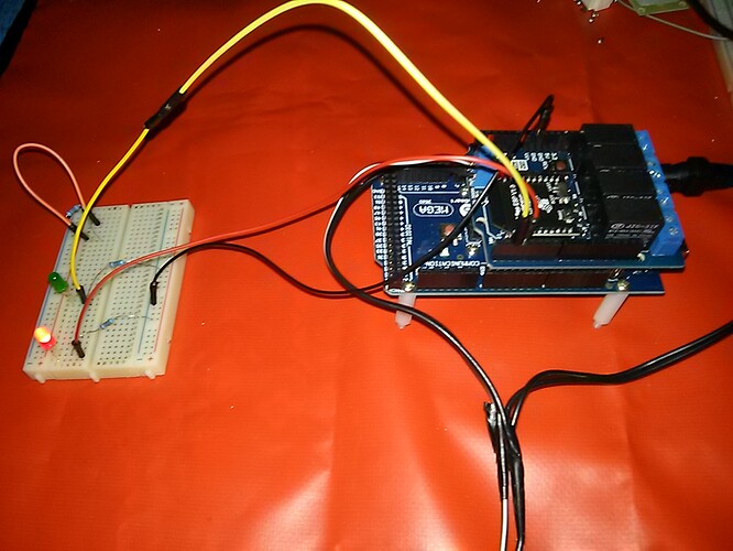

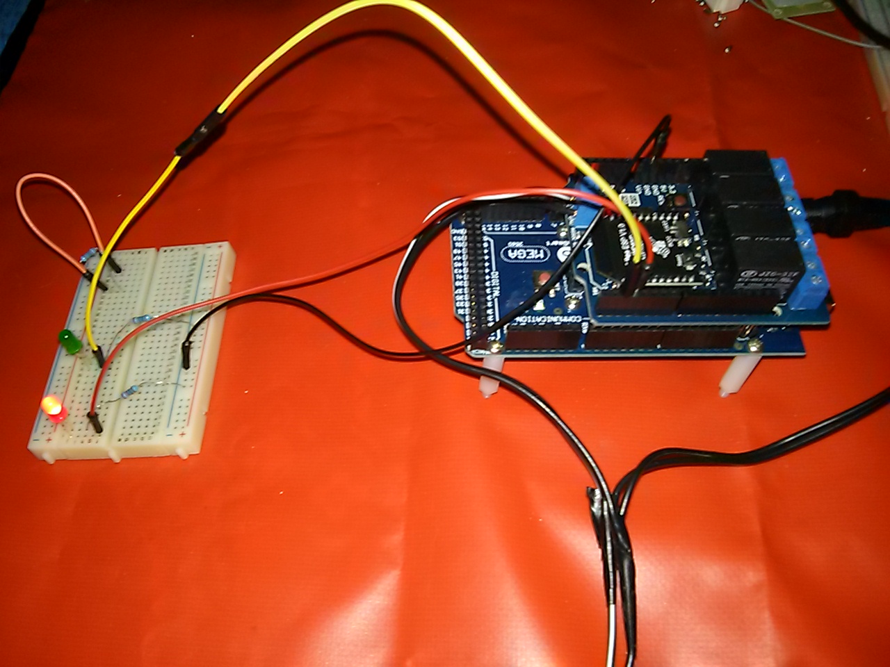

Can i mesure the voltage of the rx pin on the relay shield with a common tester?
I have just tryied loading a sketch just with empty setup and loop, connecting the module to pins 0-1, but it is not working. Actually, to be sure i didn't any mistake in the wiring (even if almost impossible...),
If you don't connect the grounds, you may have issues.
zoomkat:

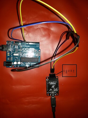

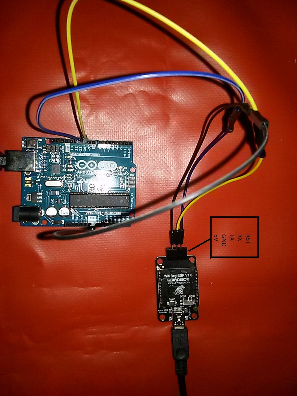

I did, here is a couple of pictures of the wirings i tryied, with the module on the relay shield (microbot) and on the usb adapter (df robot).
I'm a newbie on arduino, maybe i'm doing stupid mistakes, but... :-*
Maybe you should disconnect any/all that stuff and just try simple communication between the serial monitor and the ESP.
I forgot the pics XD
@zoomkat
what do you mean?
Using the usb adapter directly connected to the pc (no arduino) and the serial monitor i can connect, using AT commands.
Using the usb adapter and connecting it to arduino (doesnt matter if the "power line" comes from arduino or from usb source) with a "blank" sketch it gives back nothing when sending AT commands from the serial monitor.
Why are you using the USB adapter? What I described did not include an additional USB adapter as the arduino actually has a USB adapter built in. What I described is serial monitor > arduino > ESP.
zoomkat:
I will try this out!
Today i have noticed something else. If i connect the esp to the pc, via usb adapter, it connects itself to my home network, i dont know why but it stored my ssid e pwd in its flash memory. Can this be the cause of the problem?
Tryied connecting the module itself to arduino, on pins 0-1.
If i load a blank sketch i can communicate with the module using AT commands.
If i load the sketch it does not connect. I tryied with the module on pins 0-1 (no softwareSerial) and on pins 10-11 (using softwareSerial). No way to see it connected on my router!
