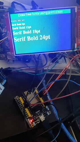

Hello,
I want to use 4.0inch TFT SPI display with Wemos D1 (ESP8266)
I download TFT_eSPI library.
When i upload graphic example with choosen ILI9341 display works with 2/3 of screen (1/3 screen is white)
With setup ST7796 i have just white screen,

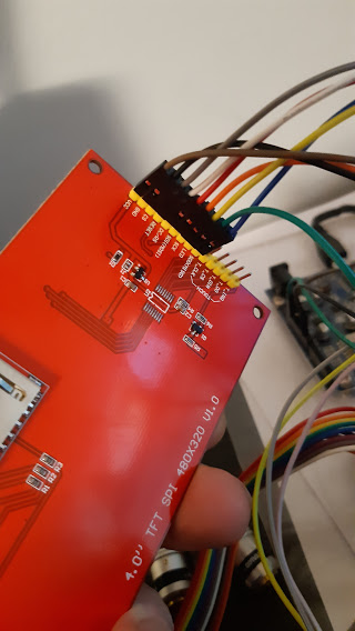

You have a Red SPI display. There is no Touch Controller.
I strongly advise you to start with User_Setups/Setup28_RPi_ST7796_ESP8266.h
comment the #define RPI_DISPLAY_TYPE
and save as your custom Setup with a descriptive name e.g. SetupNN_ST7796_ESP8266.h
Wire screen to the ESP8266 D1 board according to the defines.
Select "Wemos D1 R1" board in the IDE.
David.

I would expect everything to work now.
I have a D1 R1 board and a Red SPI with ST7796. I select "Wemos R1 D1" board in IDE.
Ok, I use different wiring (because my Adapter works on other Arduino boards):
#define TFT_MOSI D11
#define TFT_MISO D12
#define TFT_SCK  D13
#define TFT_CS   D10  // Chip select control pin D8
#define TFT_DC   D9  // Data Command control pin
#define TFT_RST  D8  // Reset pin (could connect to NodeMCU RST, see next line)
#define TOUCH_CS D3  // Chip select pin (T_CS) of touch screen
But your wiring should work 100% too.
David.

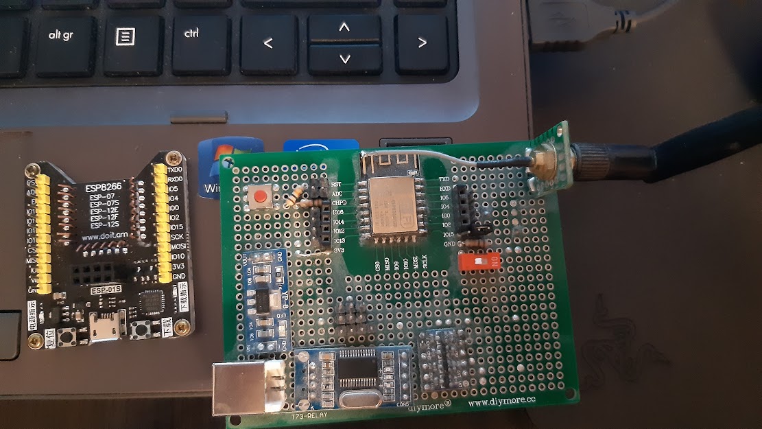

I have selected Wemos R1 D1
i have also shield made by my own very long time ago and some chinese stand for esp
i'll try to run it on them
Now its working, it must be something with Wemos.
THX for help.
There are different adress of pins in wemos
After change pins TFT works on wemos too
