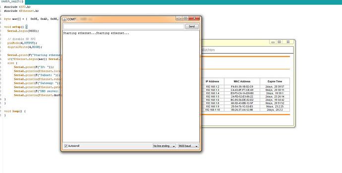

I don't understand what you mean by "don't have any result". Try the test code I posted above and post the serial monitor output. Does it show the network settings or show "failed"?
SurferTim:
I uploaded the code that you provided. I attached the image.
In the SerialMonitor I only get the message "Starting ethernet...". When I reset my device, the same message appears in the SerialMonitor. Also I attached the image of the DHCP clients, and there is no this device in the list.

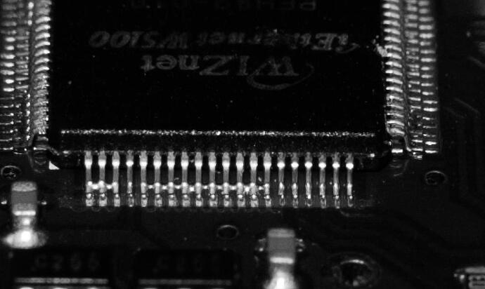

It appears you have a problem with the ethernet shield. Calling the Ethernet.begin() function is causing your Duemilanove to reboot.
Check your w5100 IC for solder bridges. That can cause that problem.

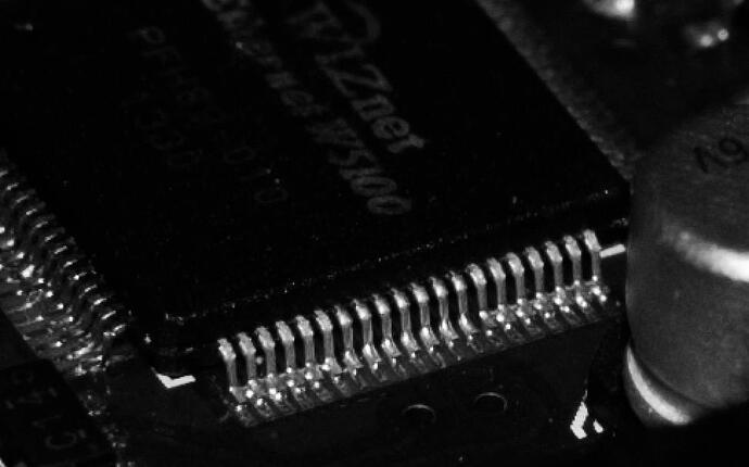

Pictures of my IC attached.
Those are solder bridges. If that is a new shield, I would contact your supplier, explain what you found, and request an exchange for a good shield.
SurferTim:
Yep, you are right. Will contact the seller.
