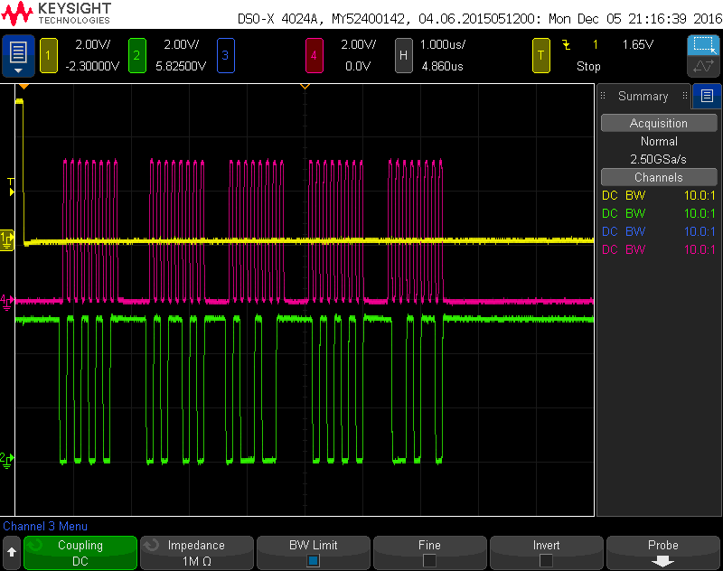

None of the libraries seem to be using "transfer (buffer, size);", this would boost the speed enormously without resorting to bare-metal code.
I decided to try a quick sanity check for this theory. I ran this code on an Arduino Due:
#include <SPI.h>
  SPI.begin();
  pinMode(10, OUTPUT);
  uint8_t data[5] = {0x55, 0x5A, 0x49, 0xAA, 0x96};
  digitalWrite(10, LOW);
  SPI.beginTransaction(SPISettings(25000000, MSBFIRST, SPI_MODE0));
  SPI.transfer(data, 5);
  SPI.endTransaction();
  digitalWrite(10, HIGH);
  delay(100);
Here is the rather disappointing result:
Then again, those 50% dead times between bytes are a LOT better than the overhead of calling SPI.transfer(byte) five times.
Here's how bad that is:
For comparison, here is Arduino Uno running the five SPI.transfer(byte) sketch:
Even with only an 8 bit CPU running at one fifth the clock speed, Uno manages to transfer the 5 bytes at only 8 Mbit/sec in approximately the total time Due does at 21 Mbit/sec.
For completeness, here is how Uno performs with SPI.transfer(buf, 5):
Your results with the Due match what I'm seeing. The Uno results put the Due to shame really given the core speed. I don't own an Uno to play with unfortunately, so thanks for sharing that research.
Does your library buffer the transfers? My results suggest they don't, but I recall reading they did (or were supposed to). I suspect it's possible to get a 100 bytes transmission done well under 100us with a buffer transfer, that's the whole UDP SPI transfer, at 28MHz.
Also, could you confirm if the timeout and retry count work with your library? They didn't seem to work for me :frowning:
Some bare metal sprinkled in and no buffering ...

SPI clock at 16.8 MHz: Without while loop, 2.17µs delay between transfers
With while loop: no delay between transfers, 0.5µs/byte, 50µs/100bytes
SPI clock at 21 MHz: 0.12µs delay, 0.5µs/byte including delay, 50µs/100bytes
SPI clock at 28 MHz: 0.22µs delay, 0.5µs/byte including delay, 50µs/100bytes

I just did a comparison between 28MHz and 42MHz, although the clocking was indeed faster, the deadtime increases to keep the 100 byte transfer at about 53us in both cases. I couldn't get 84MHz to work, it seemed to still clock at 42 :frowning:
Are you communicating with other hosts on your local ethernet? Or will you be talking to hosts on the internet, accessed through routers and high-latency links?
Yes, that matches my findings in reply 26. The SAM3X SPI hardware works without deadtime at up to 16.8MHz clock. Beyond this rate, the deadtime increases to cancel out the byte transfer time improvement because a wall has been hit.
According to the datasheet, DMA will optimize transfer rate ... I guess the DMA improvement would be noticed only if the SPI clock is set higher than 16.8MHz.
This looks interesting...
32.7.3.9 Peripheral Deselection with DMAC
When the Direct Memory Access Controller is used, the chip select line will remain low during the whole transfer since the TDRE flag is managed by the DMAC itself. The reloading of the SPI_TDR by the DMAC is done as soon as TDRE flag is set to one.
Did you try turbospi.h library for Sam3x ( GitHub - anydream/TurboSPI: This is another Arduino SPI library separated from SdFat library, it uses SPI registers and DMA (Arduino Due only) to accelerate SPI communication ) ?
Yeah, now that's more like it!
SPI SCK @ 42MHz, no deadtime, 100 bytes transferred in 19.04µs!
5.25 MBps (42Mbps)
