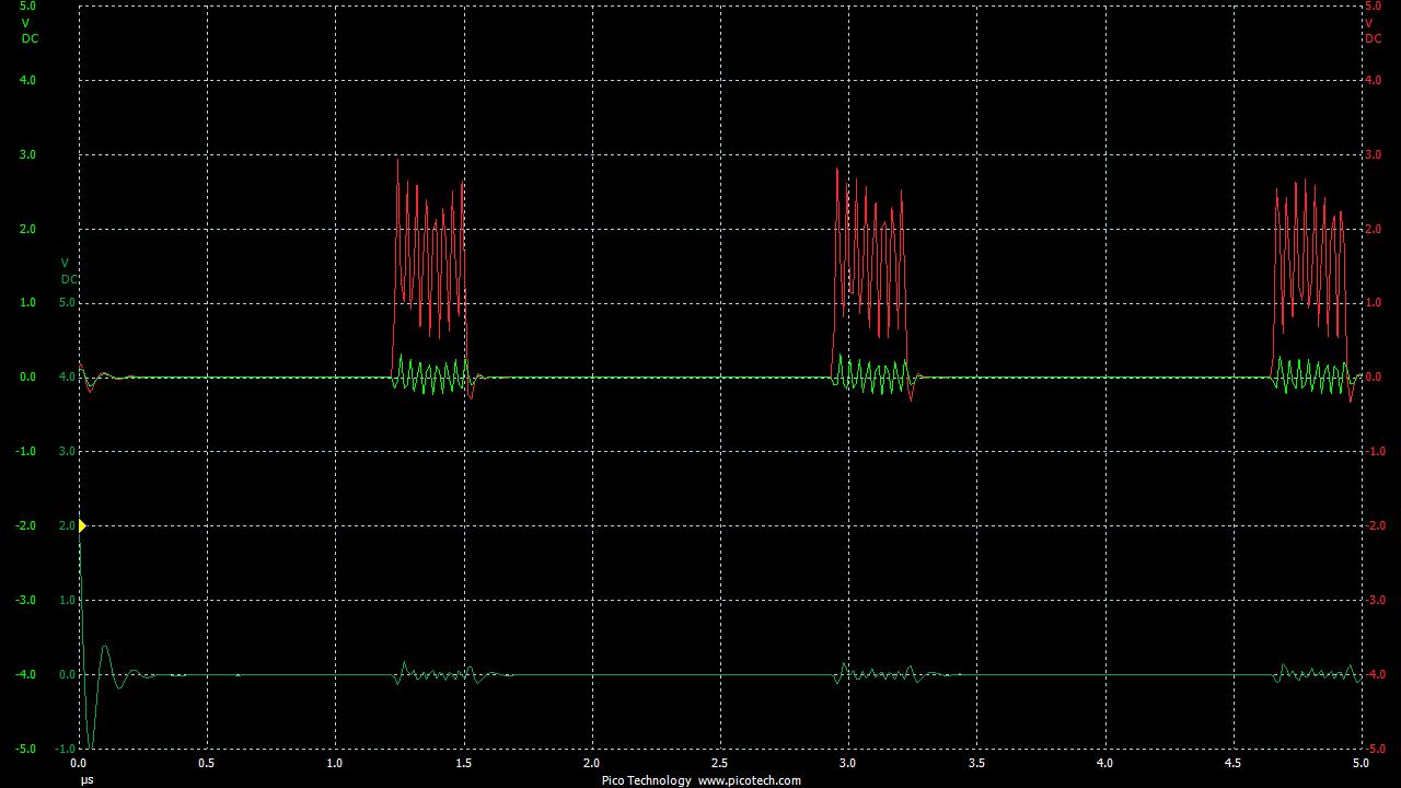

I’ve attached a scope plot showing the SPI clock (it doesn’t resolve particularly well, but it is obvious), there’s oodles of deadtime!
try editing SPI.cpp and changing the occurances of SPI_CSR_DLYBCT(1) to SPI_CSR_DLYBCT(0)
I believe the (1) will cause 32 clocks between transfers, and I believe that the comment about CS is wrong since CS is manipulated manually (SPI_CSR_CSAAT - although I'm not sure why that's missing from setClockDivider()
Doesn't seem to have made any difference, it should have knocked off 381ns (3/4 of a graticule division on the scope plot) but it hasn't. The location of SPI.cpp I edited was: C:\Users[USERNAME]\AppData\Local\Arduino15\packages\arduino\hardware\sam\1.6.9\libraries\SPI\src\SPI.cpp
The scope plot is set to trigger on the falling edge of the /CS pin, there's about 1.2us before the first SPI transaction, I wonder if all (most) of the delay is before the transaction rather than after?

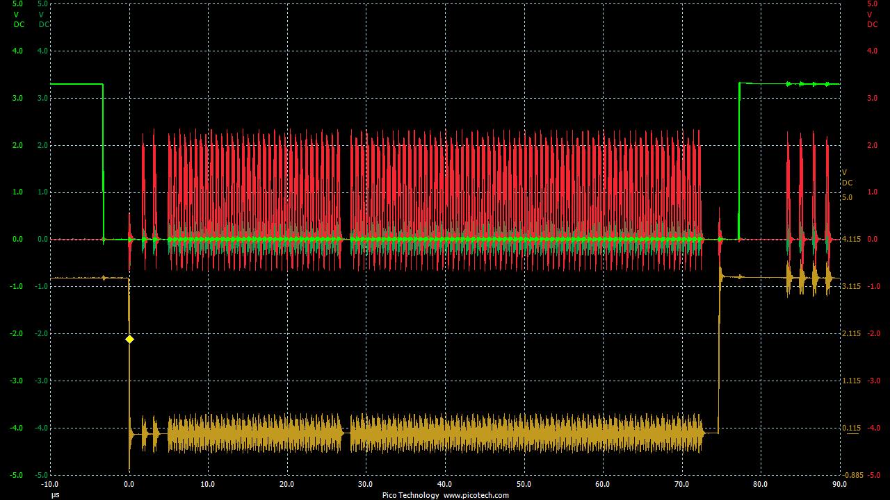

My Cpp isn’t strong but it looks like this will do both sending and receiving. Bit of a shame it overwrites the transmit buffer to do it tho :frowning:
There’s quite a bunch of commands in there, which I guess is accounting for the gap between bytes. I’m seeing a gap about a bit longer than a byte transmission time (about 1.4 times).
I’m also seeing what I guess is an interrupt occurring in the middle of the transmission (I’ve attached a screengrab of it), it’s not a huge problem in the grand scheme of things but is annoying :slight_smile:
(ignore the ends of the waveform, I’ve got other code running in there too. The first 2 transfers are a transfer16, just for comparison)
If this works, that’s an increase in speed of about 3x for a 100 byte SPI transfer, things are starting to look up :slight_smile:

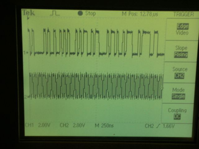

I’ve been trying to get some “bare” SPI code to work, so I can figure out whether this is inherent slowness, or some hardware/configuration issue. But I’m having troubles getting it to work :frowning:
Ahh, there is goes… This code produces a nice tight loop, and I’d really expect it to keep that SPI clock going pretty much continuously. It doesn’t :frowning: Therefore, something “interesting” is happening! (I had to modify SPI.h to make SPI.spi a publicly accessible value, but otherwise it has no modifications.)

I just about managed to alter SPI.h to make it work.... (tho I had to run your demo, I couldn't get it to work within my code).
Not much speed difference than the library, it looks like it's the while loop waiting for the clear signal
This does help significantly for the bare-metal SPI case…
With DLYBCT(1):
With DLYBCT set to zero after starttransaction:
Ah hah! I get it! Since the SPI single-byte "transaction" routines are all "return the read value", they MUST wait for the complete transmission to happen, so you get no benefit from the potential overlap of the transmission with other code. We might as well be bit-banging :-( The counted version of write() does a little better, but it's still not taking advantage of both the shift-register AND the TX buffer register.

Paul, you posted while I was still writing this post :) I did try your library yesterday (I posted in this thread: https://forum.arduino.cc/index.php?topic=438559.0) I couldn't get the retry and timeout to work, I really need these as I need to 'give up early' and carry on, I'm trying to get my looptime down
I've tried the Wiznet library (at 28MHz) and it does seem to be faster, the UDP packet is down to about 270us. Clearly the wiznet library isn't using the faster buffer transfer :(
For testing, I've got a 100 byte SPI buffer transfer (not to the W5500) followed by the UDP transfer, just so I can compare on the fly, here's the really odd thing, the wiznet library is causing a minor slowdown in the SPI time! A 100 byte transfer over SPI takes 48.6us with the Ethernet2 library in use and 52us when I use the Wiznet library. It's not a huge amount, but it is very noticeable when you are looking at 10us/div on the scope, it crosses the 5 div boundary! Looking at the waveform, it is a small increase in deadtime between the SPI bursts, very strange!
