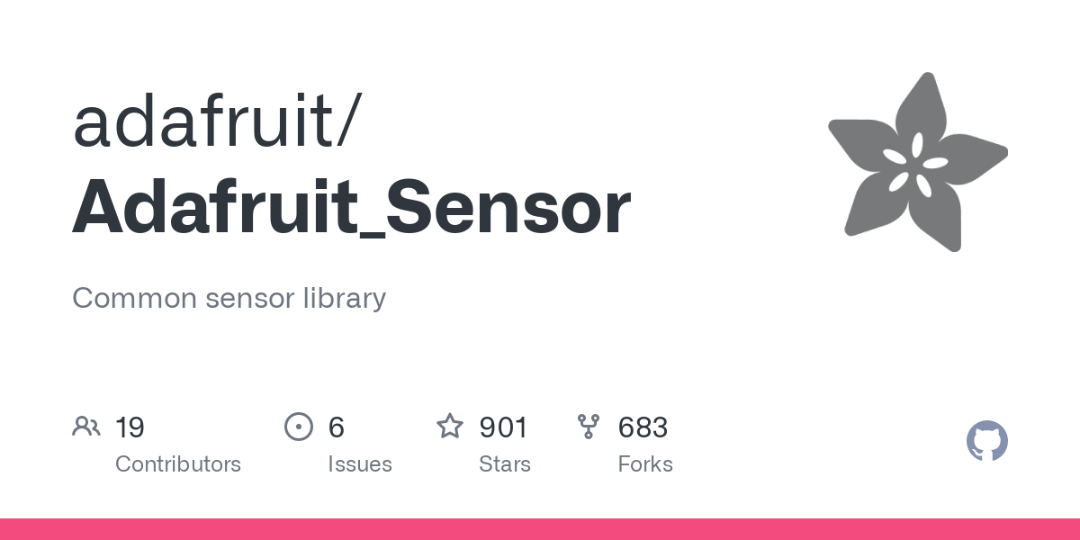

Maybe you did not install the adafruit_sensor library?
Looks like the DHT library you have installed is not the same library as used by the author of the sketch. Check the original source of the sketch to see if they mention WHICH library they use.
