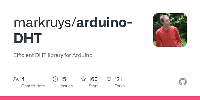

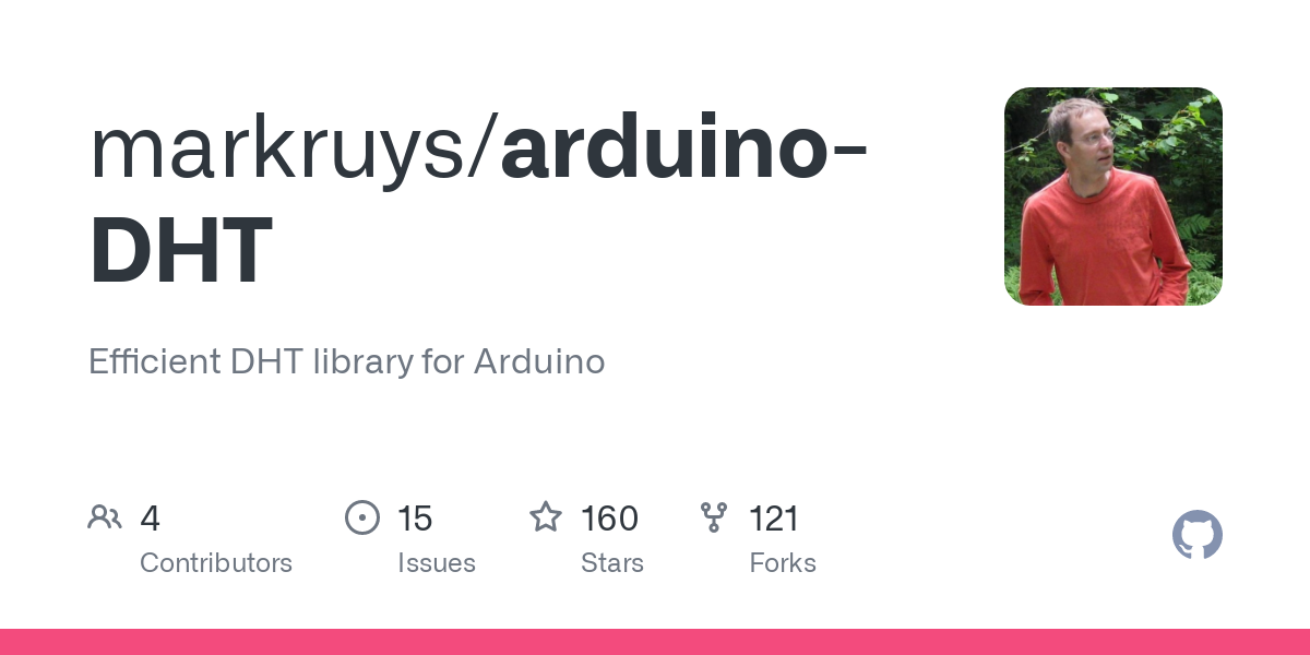

The DHT.h file is in a folder called DHT, and I downloaded it from github:
DHT Temperature & Humidity Sensor library for Arduino.
Features:
  • Support for DHT11 and DHT22/AM2302/RHT03
  • Auto detect sensor model
  • Very low memory footprint
  • Very small code
Written by Mark Ruys, mark@paracas.nl.
As I said initially, I got the sketch from circuit basics site and there was no library file include to actually download. Because it was typed as <dht.h>, I then assumed that it should be <DHT.h>. I knew I alread a DHT library, so that is what I used.
