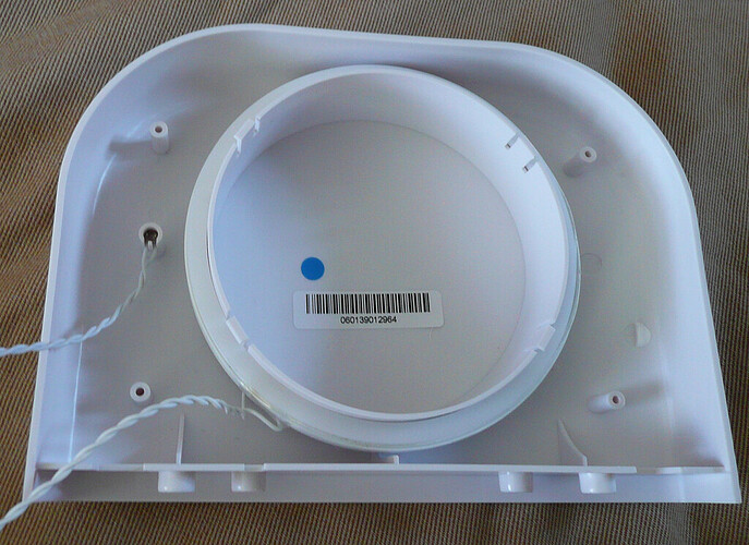

Hi all,
I wish to rebuild the Petsafe Petporte cat flap device. The one I have does not register my cat's chip. So I'm thinking of using the RC522 with an Arduino Pro or similar. The only thing is that i'm wondering whether the range of the RC522 will be enough so like other members here I was thinking of attaching the RFID antenna of the Petporte device to the RC522 by cutting the wires to the pcb antenna and soldering on the 2 wires of the Petporte antenna. Can this work?
