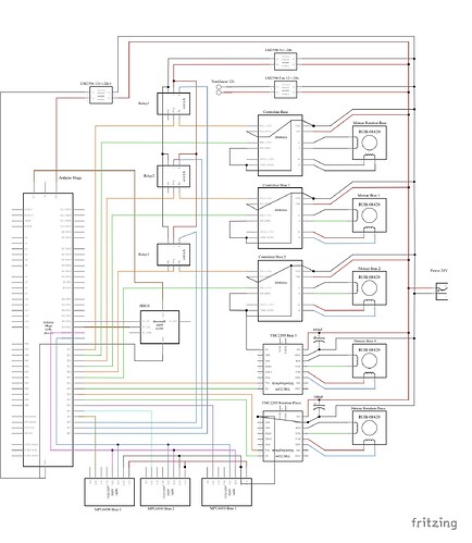

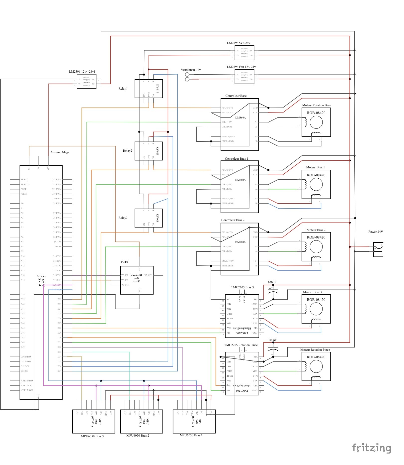

I have a project for a robotic arm powered by an external 24v power supply which powers an arduino mega at 11v on the Vin pin. However if the arduino is powered on the Vin track before being plugged into usb it becomes undetectable by the computer (tested on different computer).

Show us your schematic.
Could the too high voltage on Vin be the problem?
Here is an image of the cablage:
Thank you for your help !
