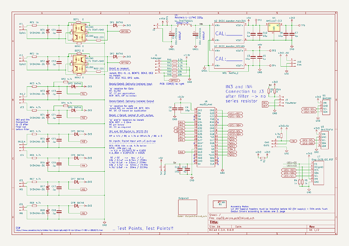

FALLING Interrupt triggers many times per event
Hello.
I recently got a new computer, and as a result, ended up upgrading all of the Arduino IDE components. IDE 2.3.4. BEFORE the upgrade, Using a three+ year old IDE, I had a falling-edge interrupt reading a signal from the output of a power meter, worked very reliably. Without changing ANY hardware, and only updating everything to work with the new IDE, I now find my falling edge interrupt triggering anywhere between 12 and 100 times per cycle. The power meter asserts its signal for ~20ms through an optocoupler output, so connecting directly to an Arduino input with pullup is no problem - and hasn't been a problem for a year and a half running on the same Arduino, two differ PCBs, but the latest for at least six months.
Then the IDE upgrade, and it feels like the Arduino is just triggering on level and not edge.
ESP32 Dev Module is the selected board.
to reiterate, this worked, exactly like this, before I upgraded the IDE and all the associated stuff.

I'm using the Arduino board "NodeMCU DevKit C V4" from AZ-Delivery. It's based on WROOM-32 SOC. The "ESP32 Dev Module" is the board configuration I use in the IDE, and it has worked fine for the last years with this Arduino module.
I can't upload a minimal sketch to the board because it runs about ten other functions I don't want to be without.
I designed and had a PCB fabricated. Schematic below. Turns out the input is actual 27, but this doesn't change that it has a pull-up. The + output of the S0 signal from the power meter is connected to JE5 pin 1 and the - to JE5 pin 2. It's been this way for over a year on the hardware in the schematic below. The only change was recompiling the code in the updated IDE.
IDE Appplication version was 1.8.16, which was the latest when I downloaded. By core version, I think you mean the "Board" driver in the IDE, but unfortunately because of OneDrive's insistance on synchronizing absolutely everything... I can't get it anymore. But I pretty much didn't update any drivers until I was forced to when I got the new computer

I don’t have a clue about the source of the problem but if the “true” falling signal shouldn’t happen faster than 500ms, you could use 200, 300, 400ms or more.
Hi @bmoerdyk2 ,
it might not be the cause in your case but I think this is interesting to read:
Slow Rise/Fall Times on GPIO inputs result in Spurious Interrupts
Briefly, in order for the rising- or falling-edge interrupts to function correctly on the ESP32 GPIO pins, both the rise and fall times of the input waveform must be short enough . My testing so far suggests that a 2 us (microsecond) or shorter transition between 10% and 90% logic levels avoids false triggering.
Just in case that you had any hardware changes that could interfere with the edges of the signal ...

ec2021. the source is the "S0" output of a power meter. Driven via an optocoupler with 100 ohm maximum on resistance, which is then pulling down through the 4.7k resistor against the ~45k pullup in the microcontroller.
This configuration has been working just fine for over a year with this hardware. the problems started when I reprogrammed it using the new IDE and new Board configuration (v3.1.1 instead of V1.0.6). I didn't change anything else.
That reminded me that lots of ESP32s do not have Schmitt triggers on inputs as the AVRs do.
Some ESP32s do have optional hysteresis:
https://docs.espressif.com/projects/esp-idf/en/stable/esp32h2/api-reference/peripherals/gpio.html#gpio-hysteresis-filter
Thank you to everyone for all the answers.
Following DaveX's suggestion, I implemented the "rate-limit" on the interrupt.
If the interrupt is triggered within 40ms of the "last" trigger, it's ignored.
This turns out to give a very stable result.
Even though I thought I was getting good results before, it's very clear now that even though it got infiinitely worse after reprogramming, that the problem existed before and that the changes in the core driver have impacted how the pins function, making the debouncing / rate limit necessary. So, ec2021 is correct in suspecting problems with the slew rate. The ~45k internal pullups are insufficient for this function.
I'll be upgrading the hardware to reduce the pullup resistance (reduce slew rate) the next time I need to take the system offline for maintenance.

The 4.7k resistor in a voltage divider with the ~45k GPIO pin pullup resistor prevents the pin being pulled lower than 0.3 volts.
I found this for ESP32 input logic voltage levels:
Input logic level low VIL -0.3 - 0.25VDD V
Input logic level high VIH 0.75VDD - VDD+0.3 V
at Voltage Ranges for Low & High - ESP32 Forum
so you may be in violation of this because the pin appears never to be pulled into a defined LOW state.
Also, as already pointed out, a prolonged period in the window where the logic level is undefined for the ESP32 could cause spurious interrupts.
I did a quick/rough simulation of this using LTspice showing 20mS pulses at two pulses per second.
zooming in, showing the pulse in the undefined range between 0.25v and 0.75v for more than 20mS.
You've already got a solution with a lockout type debouncing routine where you accept the first interrupt as valid and refuse to accept further interrutps until a timer has expired.
Another option, still using interrupts, would be to use a hardware timer called routine to check the status of the pin every say 15 milliseconds to see if there is a pulse there.
V_IL_MAX = 0.25VDD not 0.25V
0.25
VDD = 0.825V.
4.7k / (4.7k+45k) * 3.3V = 0.312V < 0.825V
my input divider is fine.
Sorry, yes of course. I misinterpreted that. Then it appears that the period the curve is in the undefined logic level area during the falling edge appears just under 1mS . Until I read the quoted article, I did not realise that there was evidence that the ESP32 was so sensitive to this.
