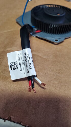

Show picture of your motor from wire side , similar to pic on post #11

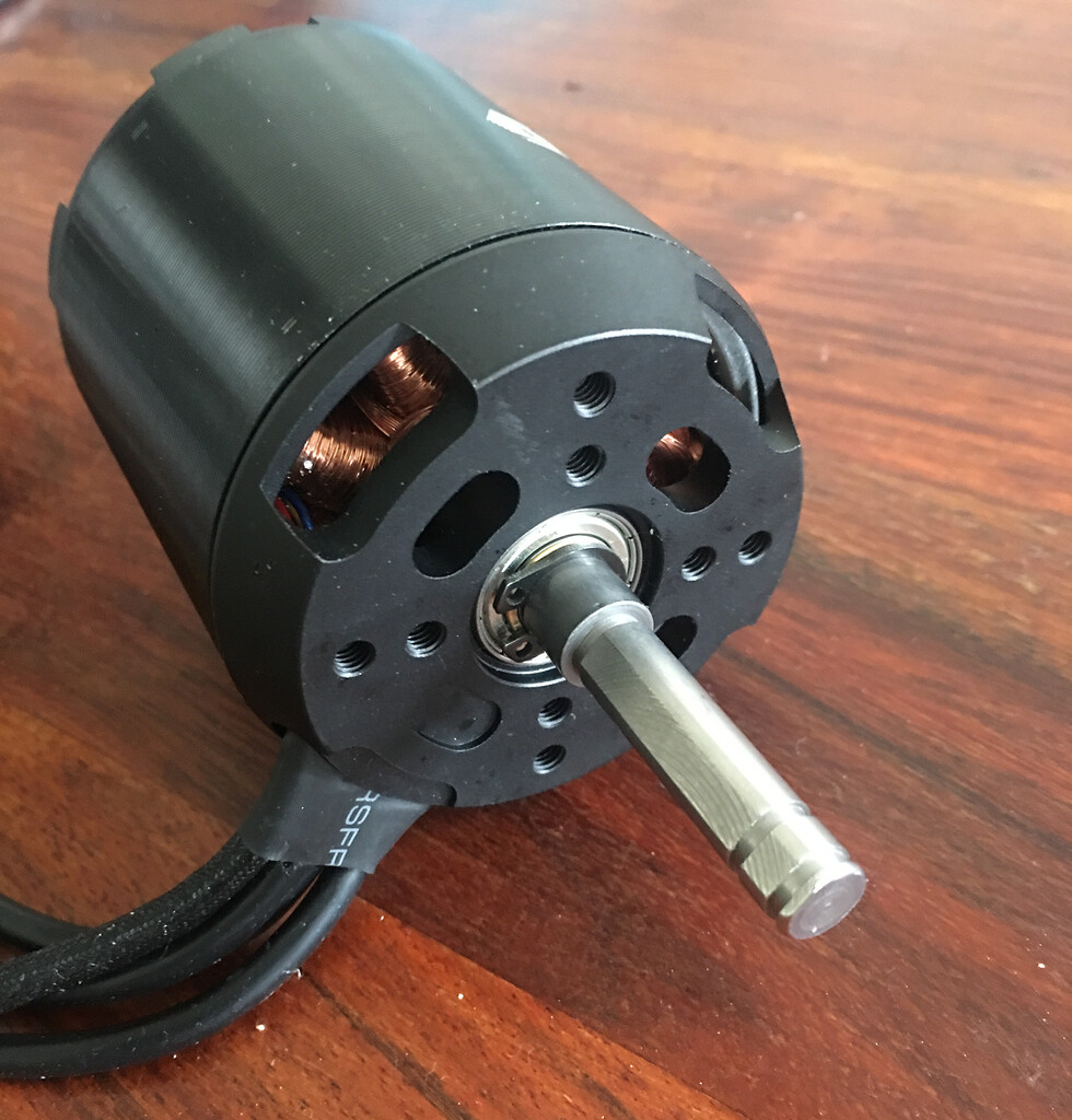

BLDC motor so a suitable BLDC driver will suffice.

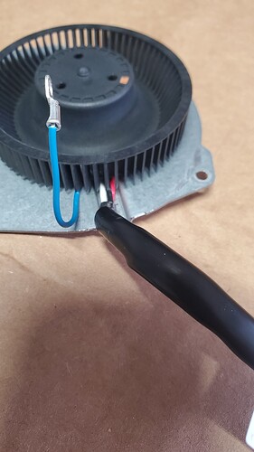

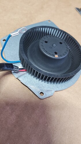

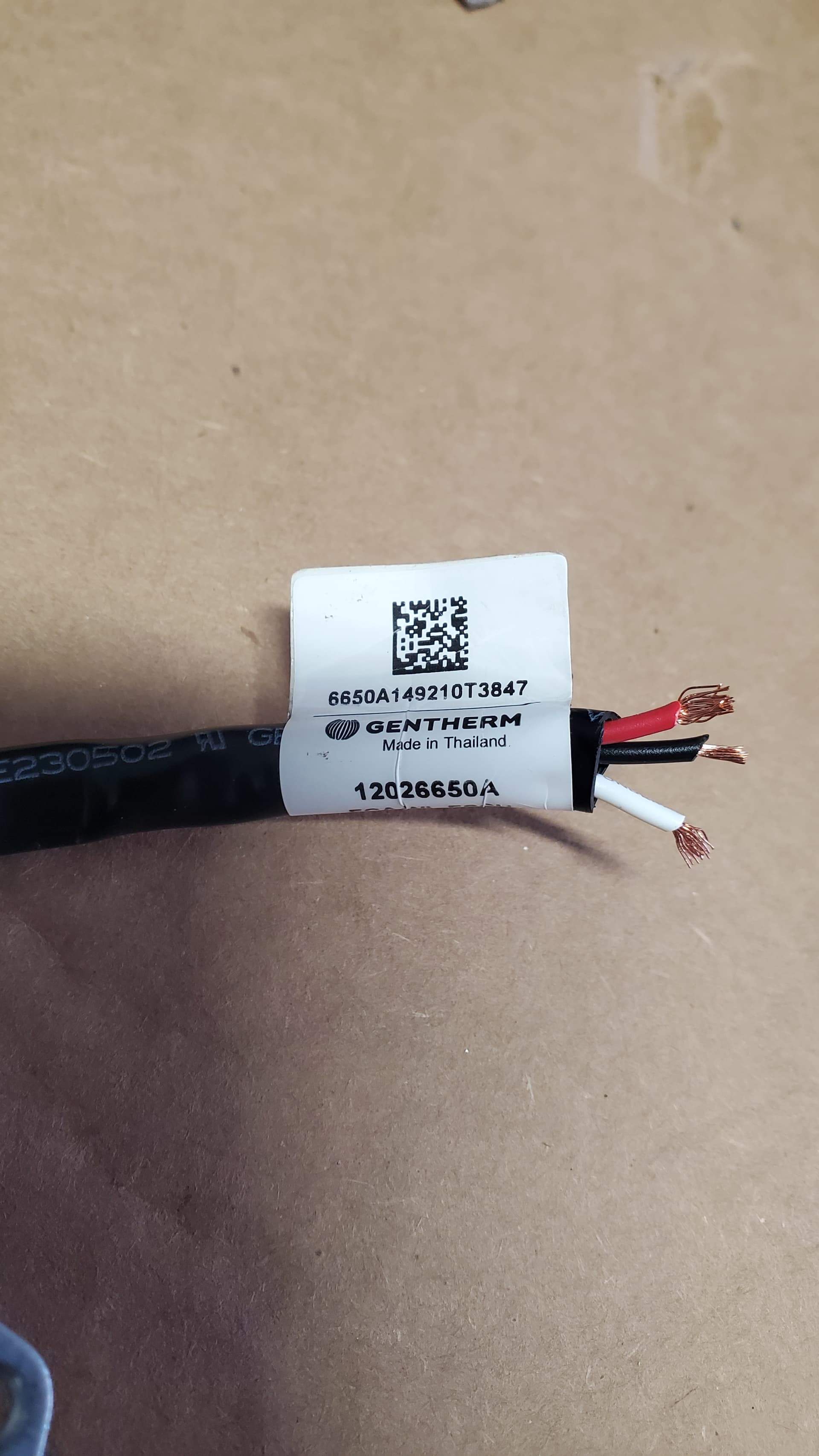

Here are a few photos of the fan. The blue wire with eyelet is captured (grounded) by one of the screws that hold the fan in place.
The one Amazon says not for brushless motors. The one Ali say brushless motors. I am going to assume the motor I am working with is brushless.
If I understand these BLDC drivers correctly they modulate the + voltage that goes to a motor, basically turning it on and off at a particular frequency. I "believe" I need something like that, but to turn on and off a ground connection. (I am still not 100% sure that is what will correctly drive this fan). Can this BLDC be wired such that it will turn the ground on and off instead of +?
When I checked the number for the motor you showed earlier ALL references were for BLDC.
Currently you have it "jerry rigged" so your present method might actually be incorrect..
You can "kick start" BLDC motors and I think that's what you are doing at the moment.
