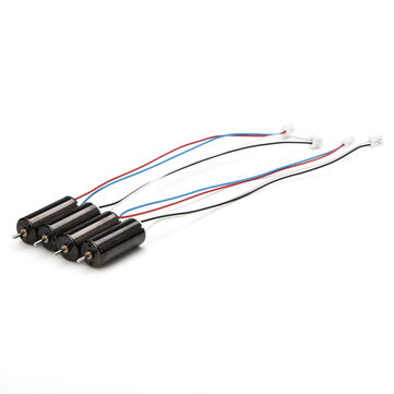

I am building a small drone. I got those motors
and smd mosfets

What is the resistance and voltage rating of the motor?

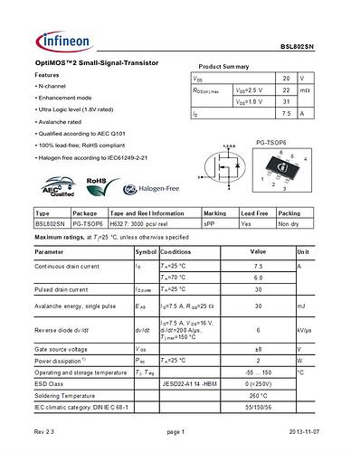

Is this running at 3.7V ? You'l need a logic-level MOSFET designed for 3.3V logic, not just 5V...
For instance: http://uk.farnell.com/infineon/bsl802snh6327xtsa1/mosfet-aec-q101-n-ch-20v-tsop/dp/2781056
Which has a low Rds(on) of 22 milliohms at 2.5V gate drive.
Yes, the motor runs on 3.7V. Does this mosfet have to transistors inside? why does it have 6 pins?
Did you look at the "Technical Datasheet" on that page.
That .pdf shows the drain connected to four pins (thermal dissipation).
Leo..
Data sheets are your friend!
Looking at the specifications of the motor:
No Load Current: 280mA max
Stall Current: 10,570mA
The FET is rated at 115mA.
Need I say more?
