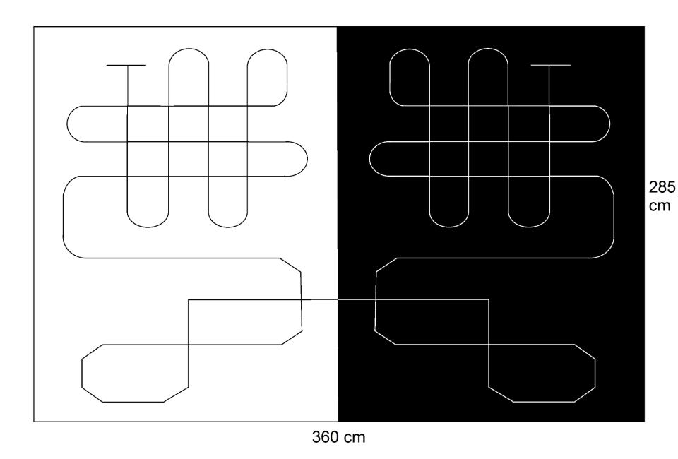

please do any one help me on this track...
this is a track of line follower bot...the bot must complete in the least time...i wanna use arduino uno
suggest me on
*what are the sensors that are to be used and
*design of the bot
*source code...........
i have some ideas and im on it but waiting for the best suggestions...
*design of the bot

Cool! I was thinking that PID would be a good approach.
An array of sensors can return more than On or Off the line, but "how far off". How can that kind of information be input to a PID algorithm??
