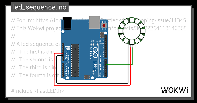

So I put four leds in a sequence and let them rotate around:
// Forum: https://forum.arduino.cc/t/fastled-visual-looping-issue/1134527
// This Wokwi project: https://wokwi.com/projects/366722641131463681
// A led sequence of four leds:
//   The first is dim
//   The second is bright
//   The third is dim
//   The fourth is off (the default is off)
#include <FastLED.h>
#define NUM_LEDS  12    // Number of NeoPixel leds
#define PIN       5     // Data pin for ledstrip
int index = 0;          // index of led at the front
CRGB leds[NUM_LEDS];
CRGB sequence[4] = {CRGB::DarkViolet, CRGB::Violet, CRGB::DarkViolet, CRGB::Black};
  FastLED.addLeds<WS2812B, PIN, GRB>(leds, NUM_LEDS).setCorrection(TypicalLEDStrip);
  FastLED.clear();       // turn all leds off
  EVERY_N_MILLISECONDS(150)
    // put the sequence somewhere on the leds
    for(int i=0; i<4; i++)
      leds[ToIndex(index-i)] = sequence[i];
    // Update the ledstrip
    FastLED.show();
    // advance index for next time
    index++;
    if(index >= NUM_LEDS)
      index = 0;
// Bring a number into the range of the array.
// A negative number can not be too large.
// but it will work for this code.
int ToIndex(int i)
  if(i < 0)
    i += NUM_LEDS;
  return(i % NUM_LEDS);
Try it in Wokwi simulation:

That does not fix it. I'm sorry to say, but that code is not good :woozy_face:
The normal way is to divide the whole array by the size of an element.
These show both ways to get the element size. They are both okay.
  Serial.println(sizeof(sequence)/sizeof(sequence[0]));
  Serial.println(sizeof(sequence)/sizeof(CRGB));
See how did you know that CRGB is something to get the size of?
Like i can simply count through CRGB leds[NUM_LEDS]; so why do i need to /sizeof (CRGB);?
Any single variable type, structure or class has a size and can be an object of sizeof(). Any variable of these types also can be "sized" by this function - so you even don't need to know, what is CRGB - type or instance
The FastLED array is not initialized for certain values.
So it makes sense to do this:
By doing that, the 'NUM_LEDS' can be used in the sketch.
Suppose that the "sequence" array can be any size, then the code would be this:
CRGB sequence[] = {CRGB::DarkViolet, CRGB::Violet, CRGB::DarkViolet, CRGB::Black};
In the code, the number of elements of the array has to be calculated. It is an array of CRGB things, so the element size is such a CRGB thing.
    int n = sizeof(sequence)/sizeof(CRGB);
    for(int i=0; i<n; i++)
That works, and I have my sketch at Wokwi updated for that: FastLED, a led sequence of four leds - Wokwi ESP32, STM32, Arduino Simulator
However, it you like to have 'NUM_SEQUENCE_LEDS' and use that for the array:
#define NUM_SEQUENCE_LEDS  4
CRGB sequence[NUM_SEQUENCE_LEDS] = { ...
That is okay as well. It is less flexible code, but it is good and it works.
