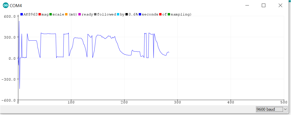

Hi, thank you very much for this. I have encountered 2 things on your code that I'd like to ask you:
  1. The "MahonyQuaternionUpdate" produces results which oscillates too much (see picture attached)
Why do you think this happens?
  1. I've tried to use the " MadgwickQuaternionUpdate" using your fix, but I get values from 0-180 degrees only.
Is there a way to get values from 0-1=360 degrees?

  1. That is not oscillation, that is compass wrap (0-359 degrees).
  2. 0-359 is valid for only one angle in 3D angular systems, and that is usually yaw. For the other two, you are limited to 180 degrees each and then the orientations repeat. Or worse, you encounter "gimbal lock". See http://www.chrobotics.com/library/understanding-euler-angles

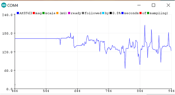

Hi, thanks for your prompt answer. Actually I've got those figures trying to move the sensor 90 degrees.
Look at this picture attached. This is the Madgwick filter when the sensor is just moving a little. This is a plot of the YAW. Values oscillate and for some reason, they are not very accurate.
Do you get good YAV values? meaning, you rotate the sensor 360 degrees (or 90) and you get a good plot?

This looks like what i get if i do not calibrate all systems completely. Dis you do the full calibration routine on Gyros, on Acellerometers and on Magnetometers?
Also, the SparkFun has the addition/subtraction of the calibration values commented out by default. You need to include them or you will not get usable results.....simply uncomment these in the code.

How do you move in 8's? The sensor needs to move in all directions about all axis.....just moving it in an 8 does not work if it not tilted, flipped and rotated while doing so....
Hi, thank you for replying and your help.
Your recommendation helped a little bit. But I am still unable to get a good 0-360 angle measurement for the YAW. I am starting to give up on this code.
See picture attached, that's what I got from several rotations over 360 in the Yaw direction. As you can see, it never goes down to zero or even to 360.
