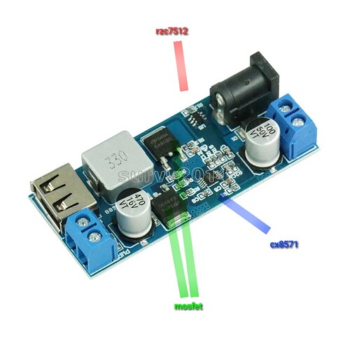

Faulty reads from DHT22 sensors after I changed PSU from 230V>5V samsung phone charger to this DC-DC step down (https://www.aliexpress.com/item/33019167151.html ).
Setup:
dc source
arduino nano
4pin SPI to LCD2004
8pin Digital IO to DHT22 sensors
2pin 5V DC to DHT22 sensors
Could some ripple voltage affect the readings?
It's odd since that DC DC has USB port too (that would mean use it with usb stuff like phones etc).
Have you experienxe with bad (not regulated) DCDC?
Is phone charger a REGULATED 5V output?
Thanks

I'm analysing the DC DC module.
The semiconductor are:
gebrey
August 9, 2024, 10:31pm
5
Ok. I think the problem is unregulated power source, compared to a phone charger that is used to power a wide range of devices, imcluded sensitive stuff.
A LM317 1.5A source probably works better. A bit disappointed.
I will rry with 1000uF cap at output
