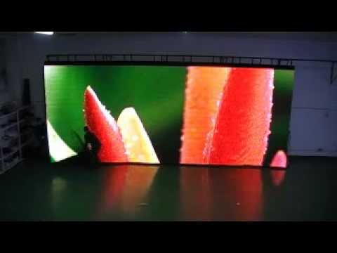

You might look into RGB led strips. I have seen 5m strip with 300 individually (60 per meter) controlled RGB leds with power, controller and remote for about US$24. You would only need 84 of those!
Yes, expensive but you can make roll-up/down curtain if you want and relatively quick and easy build, use, store, move compared to panels.
People already build less ambitious video walls and curtains:
