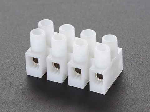

Rather than a breadboard where wires can come out or become loose, try these connectors

Thank you for the suggestion and I'll look into these connectors.
