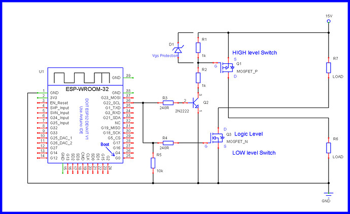

Yes, that's exactly what I was picturing in my head. Well, almost. I understand the voltage divider on the P-Channel. On the N-Channel, I was thinking it would need a pull-down resistor, but not thinking about a second resistor. I'm guessing this is for current limiting to protect the ESP?

The second resistor is for current limiting.
In many automotive applications, the switching is done on the high side (high level).
Consider a limited example: If I want to control a small light, it will be supplied by power from a switch in the dash connected to 12V from the battery/power system. The light will be connected to chassis ground at the other end. There will likely not be a negative wire coming back to the switch.
To control it low-side, I would need to add a negative wire back to the switch. The light would always have 12V present.
It is possible to do high side switching with an N-channel using a bootstrap capacitor circuit. May end up being an easier to implement solution.
For my purposes, i will not be switching any factory devices, so running a ground back to the controller wouldn't be a problem.
I could potentially design it for both scenarios to be "future proof" though. Could two FETS be controlled by one output, maybe having a 3 pin connector with +12v, N-Channel output, P-Channel output? Could do 4, but i left out GND figuring in that scenario it would be likely grounded to the chassis.

The Circuit should work.
At switch-on, the two current limiting resistors, in parallel, will allow a draw of about 27 mA. I think that should be OK for the ESP32 but you may want to check the data sheet.
And once fully on, the FET will not be drawing a current. The current drawn by the NPN will depend.

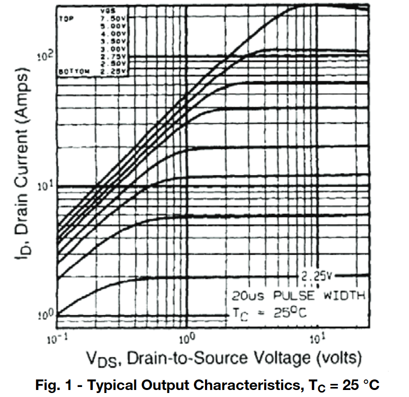

What do you think of these options for this application?
N-Channel: IRLZ44SPBF
P-Channel: SPD50P03LG
The selected MOSFETs need to completely turn ON at the applied Vgs, if this is 3.3V measure Vds with you DMM.
If Vds is a low value, you will be okay.
Say Rds(on) was 50mΩ @ Vgs = 3.3V
Assume the Drain current was 1A.
Vds = 1A * .05Ī© = .05V
MOSFET power = .05V * 1A = .05W (cool)
It is very important you confirm Vds(on) with your voltmeter.
Would this help figure that out? I don't have one yet to test, but I'm thinking my max current is going to be 10 amps.
The MOSFET should saturate @ 3.3V.
However, we always confirm a new design of a MOSFET switching circuit by measuring the Vds voltage when we turn the MOSFET ON.
Later when we have confirmation the circuit works as we want, we can assume new PCBs will be fine.
