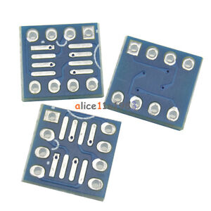

SOIC-8
SOIC-8 to DIP PCB
50PCS SOP8 SO8 SOIC8 TO DIP8 Interposer board pcb Board Adapter Plate

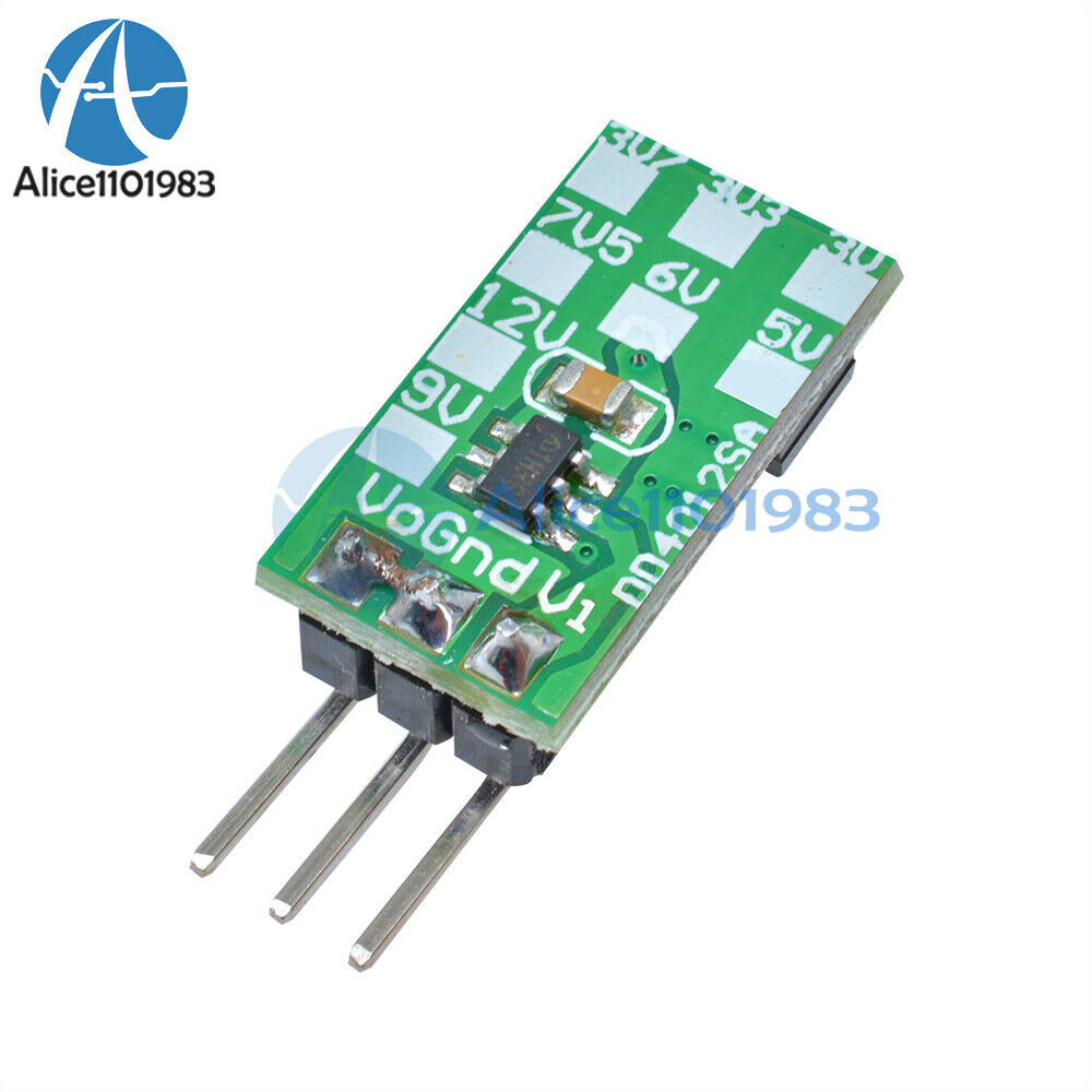

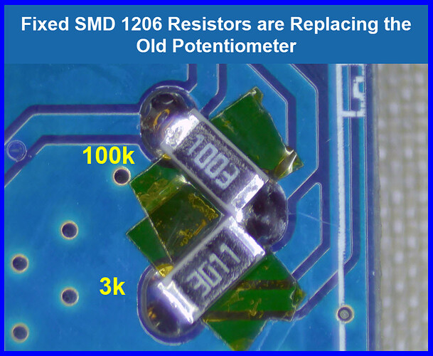

Slightly off topic, but what do you think of this for power?
The good thing about these regulators is efficiency.
The downside to switching regulators is the need for a lot of external components and extremely careful board design.
Over the years I’ve settled on using ready made converters.
These are inexpensive, have a relatively small foot print and are a proven design.
Use them as daughter cards on a PCB.
Example

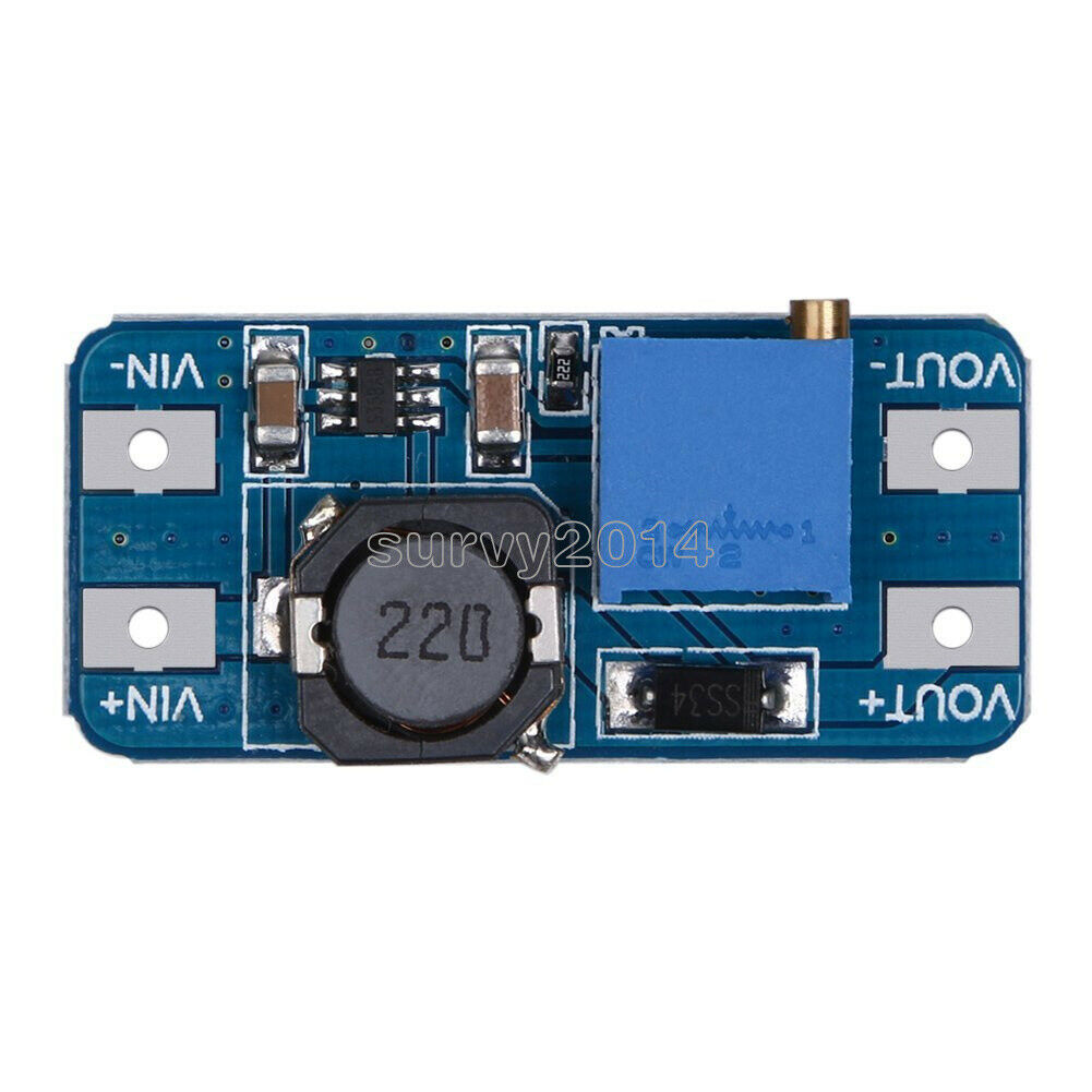

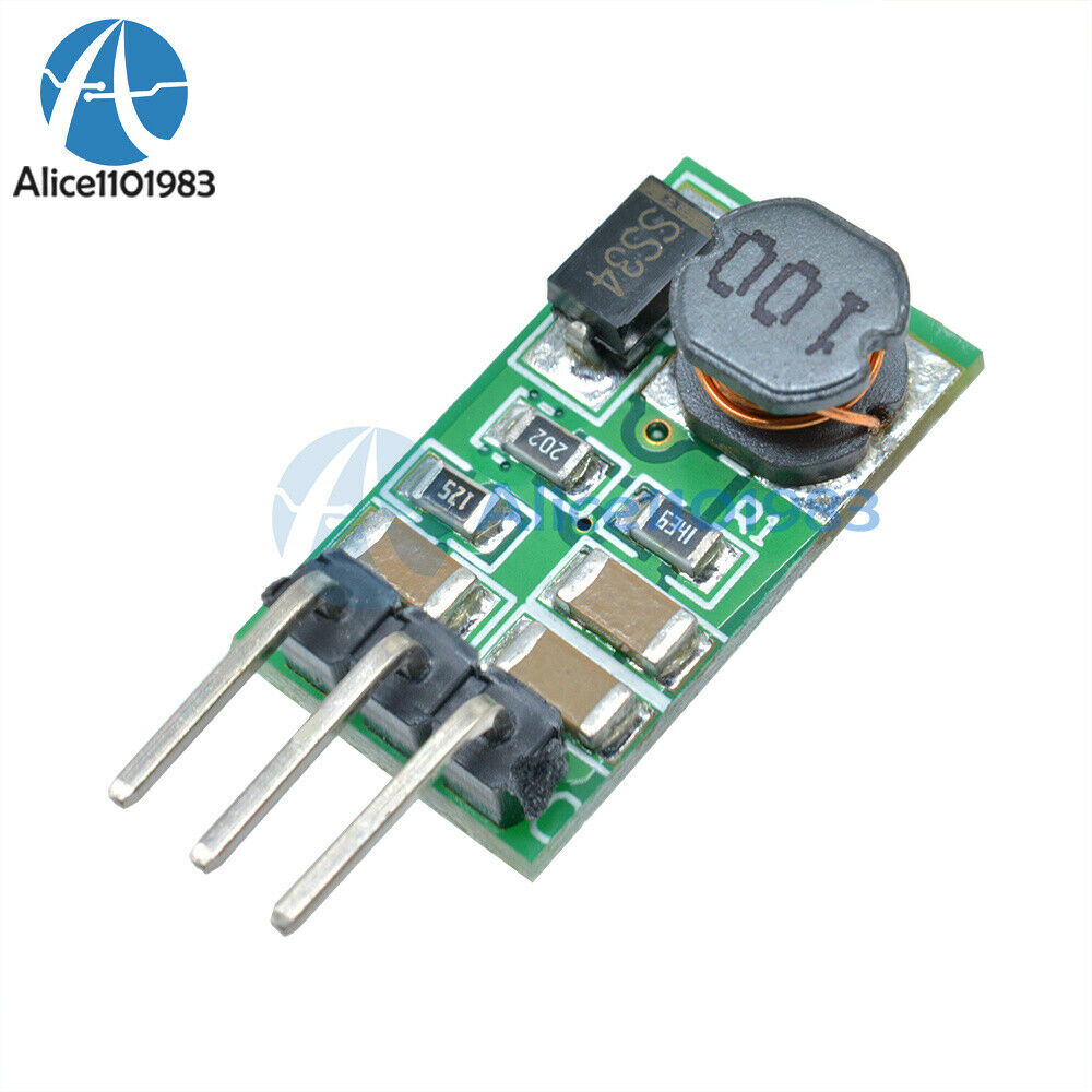

For a boost buck converter, I use these:
For a boost converter:
For a buck converter:

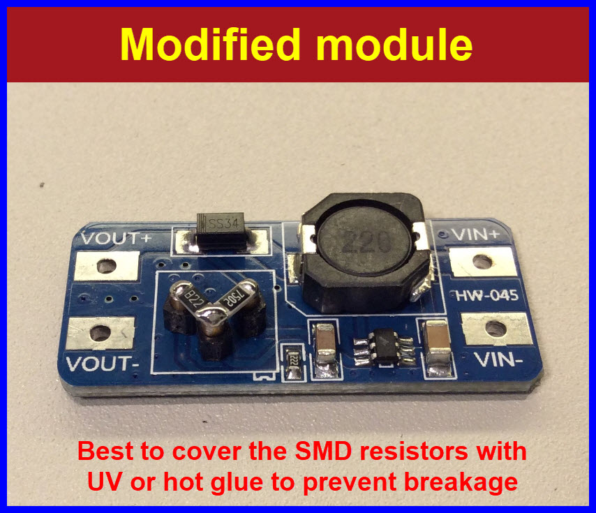

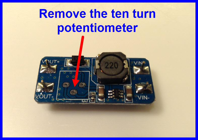

I have used something like that once before. I'm not a fan of the ones with a potentiometer though. Over time they get dirty or vibrations make them lose their adjustment. I had one powering an Onion Omega 2+ and couldn't figure out at first why it wouldn't boot. Seemed to be powering up, light was flashing, but never went steady saying it was booted and connected to WiFi. Turned out somehow the voltage went down just enough that it couldn't read the storage and boot.
That’s why I remove them and add fixed resistors.
