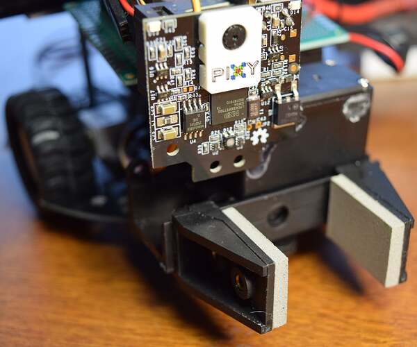

I am trying to build a fetch robot using a Arduino Uno, Pixy2 and two continuous servo motors.
I found this sketch.

But unfortunately this project uses dc-gear-motors and a ESP32-controller. I am also not sure, if the wiring-scheme is correct.
Maybe someone could help me modify the sketch?
Thank you very much for any help or hints!

Thank you! I'll try my best. :smiley:
I modified the code and also included some more Pixy2 libraries since the orignal sketch uses the 'pixy.ccc.getBlocks' function.
When I tried to compile the new code I got

Arduino IDE is now compiling without any error messages, but the servos still wont move.
Pixy2 seems to recognize the objects/signatures I set up in PixyMon but the only output I get on Serial Monitor is
"Starting..."
Any ideas? :roll_eyes:

Right servo is turning now. :smiley:
I took a look at the "hello_world" demo, added the libraries again and renamed "Pixy2I2C pixy;" to "Pixy2 pixy;"
Serial monitor is also giving me some output now.
I'll get back on this tomorrow. :sleeping:

#include <Pixy2Video.h>
#include <Pixy2Line.h>
#include <Pixy2.h>
#include <Pixy2SPI_SS.h>
#include <Servo.h>
Pixy2 pixy;
#define CENTER 102
#define DEADZONE 8
Servo right_servo;
Servo left_servo;
Servo gripper_servo;
int right_servo_pin = 5;
int left_servo_pin = 6;
int gripper_servo_pin = 9;
int pos;
int state = 1;
const int freq = 490, resolution = 8;
  Serial.print("Starting...\n");
  pixy.init();
  right_servo.attach(right_servo_pin);
  left_servo.attach(right_servo_pin);
  gripper_servo.attach(gripper_servo_pin);
  set_gripper_servo(0);
  delay(2000);
  set_gripper_servo(1);
  int i;
  // grab blocks!
  pixy.ccc.getBlocks();
  // If there are detect blocks, print them!
  if (pixy.ccc.numBlocks)
    //Serial.print("Detected ");
    //Serial.println(pixy.ccc.numBlocks);
    for (i=0; i<pixy.ccc.numBlocks; i++)
      /*Serial.print(pixy.ccc.blocks[i].m_width);
      Serial.print(" ");
      Serial.println(pixy.ccc.blocks[i].m_height);
      /*Serial.print("  block ");*/
      //Serial.print(i);
      //Serial.print(": ");
      //pixy.ccc.blocks[i].print();
      if(pixy.ccc.blocks[i].m_width > 220){
        if(pixy.ccc.blocks[i].m_x >= CENTER-DEADZONE || pixy.ccc.blocks[i].m_x <= CENTER+DEADZONE){
          Serial.print("Grabbed at ");
        Serial.print(pixy.ccc.blocks[i].m_x);
        Serial.print(",");
        Serial.println(pixy.ccc.blocks[i].m_width);
        set_gripper_servo(2);
        right_servo.write(91);  //Stop
        left_servo.write(93);
        state = 0;
        right_servo.write(180);  //Back
        left_servo.write(-180);
        delay(750);
        while(1);
    Serial.print(",");
    if(state==1){
      right_servo.write(-180);  //Forward
      left_servo.write(180);
      delay(2);
    else if(pixy.ccc.blocks[i].m_x > CENTER){
      //while(pixy.ccc.blocks[i].m_x > CENTER){
        right_servo.write(-180);  //Left
        delay(1);
    else if(pixy.ccc.blocks[i].m_x < CENTER){
      //while(pixy.ccc.blocks[i].m_x < CENTER){
        right_servo.write(180);  //Right
        delay(1);
  if(Serial.available()>0){
    pos = Serial.parseInt();
    Serial.println(pos);
    if(pos != 0){
      gripper_servo.write(pos);
void set_gripper_servo(int state){
  switch(state){
    case 0:
      gripper_servo.write(180);//closed
    case 1:
      gripper_servo.write(0);//open
    case 2:
      gripper_servo.write(60);//grip
In the meanwhile...
TheMemberFormerlyKnownAsAWOL:
Why are you messing with the Pixy libraries?
That's a good question. :grinning: Any ideas, why the error message showed up when compiling the sketch?
Will also try to get some infos directly from the Pixy-Team.
Found the declaration in another file
#define PIXY_TYPE_RESPONSE_ERROR             0x03
Do I have to include pixydefs.h manually in the library and my sketch? In other words: why is Pixy2CCC.h not referring to this declaration?
Fixed some code
left_servo.attach(left_servo_pin);
Almost there...
Almost there... :smiley:
v5
#include <ZumoMotors.h>
#include <Pixy2CCC.h>
#include <ZumoBuzzer.h>
#include <Pixy2UART.h>
#include <Pixy2I2C.h>
#include <PIDLoop.h>
#include <TPixy2.h>
#include <Pixy2.h>
#include <Servo.h>
Pixy2 pixy;
#define CENTER 102
#define DEADZONE 8
Servo right_servo;
Servo left_servo;
int pos;
int state = 1;
  pixy.init();
  delay(2000);
  int i;
  // grab blocks!
      Serial.print(" ");
      //Serial.print(i);
        Serial.print(",");
        state = 0;
        delay(750);
        while(1);
    Serial.print(",");
    if(state==1){
      delay(100);
      delay(20);
        delay(20);
        delay(20);
        delay(20);
        delay(20);
    if(pos != 0){
  switch(state){
    case 0:
    case 1:
    case 2:
