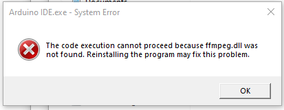

Ffmpeg.dll not found, ZIP install 2.3.6

Looked at the previous similar post and tried adding this file to the malware allow list (in fact I added the whole directory) but the IDE still won't start.
This is my first install so I can only guess that the ZIP install (I do not want this on the system disk) is incomplete in some way.
I am however in the dark and definitely in need of help.

As for libraries the install didn't work, as previously mentioned the IDE won't even start because of this missing file. Sadly the error message does not say where that missing file should be located so offering zero help as to a fix.

See if the advise in Arduino IDE fmpeg.dll error - #18 by ptillisch solves the issue.
Many thanks for that but I did read that post and thought great its fixed. but it wasn't.
Its possible I have not put the correct file into the Allow list so I put the whole Arduino directory on the list. However the error message did not say where this file is located so its quite possible its lurking somewhere on the C: drive - I just don't know.
Also the error complains about the file FFMPEG not to be picky but is that the same?
The error that you show is about ffmpeg.dll. The file should be in the installation directory (marked in red in below)
Its there but; I just added that to the allow list and also told the threat scanner to check it and it passed.
Is this because I used the ZIP option and expanded it NOT on the C: drive? Could I ask, if you installed on the C: drive could you let me have the directory the C: drive install would expect to find it in so I can create and copy this file in the hope its that simple. Could this be a PATH issue?

I just added the Arduino directory mentioned previously to the windows path and the error stopped and I am in. (type ENV in the search box)
