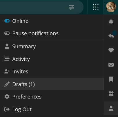

Did you check the drafts?
I composed it in my text editor, prior to opening a forum reply. There was no trace anywhere after the power came back.
