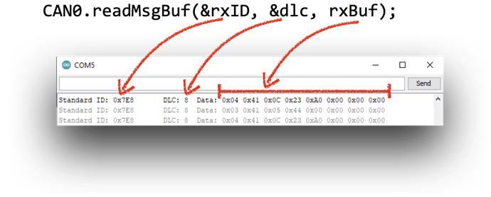

i have attached what some of the data looks like on the serial monitor in the picture

It might be slightly tricky to do it in a general purpose or elegant way, but for your first attempt I would think brute force would serve you well enough:
if(rxID == 0x7E8 && rxBuf[0] == 0x03 && rxBuf[1] == 0x41 && rxBuf[2] == 0x05)
  CoolantTemp = rxBuf[3];  // You'll need to declare this variable somewhere
The stuff you see on the serial monitor comes from the request
CAN0.readMsgBuf(&rxID, &dlc, rxBuf);
the 8 bytes of data you see in the Serial monitor come from this for() loop
     for (byte i = 0; i < dlc; i++) {
        sprintf(msgString, " 0x%.2X", rxBuf[i]);
        Serial.print(msgString);
==> so it's the content of the rxBuf buffer and you have dlc bytes to print
it's just a matter of accessing
 rxBuf[the right byte number]
to extract stuff
So to @wildbill stuff is almost right, if you received
7E8 03 41 05 40 XX XX XX XX
the 0x03 is actually DLC so
if(rxID == 0x7E8 && dlc == 0x03 && rxBuf[0] == 0x41 && rxBuf[1] == 0x05) {
  CoolantTemp = rxBuf[2];  // You'll need to declare this variable somewhere
(assuming it's always 41 05 before the coolant temp)

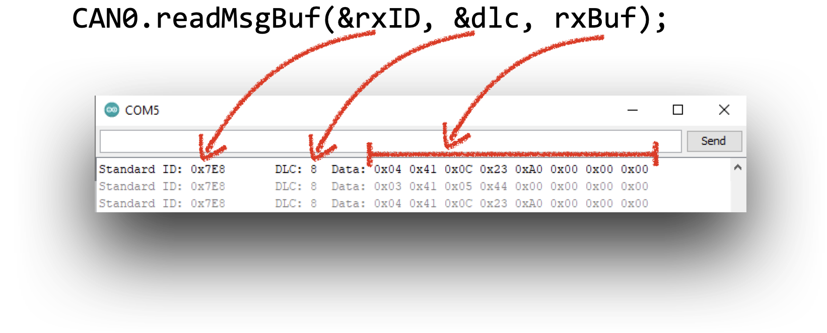

I disagree. Dlc comes from here:
Obviously it was on the wire but it's not part of the 'data' packet. Note too, that it's eight, not three in this case.
yes dlc comes from there, as shown in my small drawing
I assumed that when OP said he is receiving
that was the plain answer from his request command "7DF 02 01 05 55 55 55 55 55"
the 7E8 was the standard ID (the rxID from the readMsgBuf call), then the next byte was the payload size (3), thus the DLC, saying that you really have 3 meaningful bytes + the rest is padded with 0x00 (the XX in OP's frame)
may be I'm wrong and you're right. I don't know enough about OBD
I suspect that the confusion is that the OP is likely reporting what was received based on what the borrowed code shows in the serial monitor. Since I know nothing about OBD either, we'll need a response from the OP to know for sure.
indeed.
at the end of the day, the data is somewhere in the rxBuf buffer, just need to get the right index :slight_smile:

Yes that’s how you print stuff out, the same way the rxBuf was printed out by the for loop I highlighted.
I’m still confused if you’ll receive the DLC as part of the frame as you mention
So I would have thought 7E8 is the ID, 03 the DLC and then you have 7 bytes with only 3 meaningful
Or is DLC just always 8 and thus not part of the frame ?
i see the confusion now.
i left out the DLC part, because for this project, it is always 8.
but the 03 in the first data byte means there is only 3 useful bytes of data after the first byte.
i will get the hang of this eventually. thank you for working with me.
