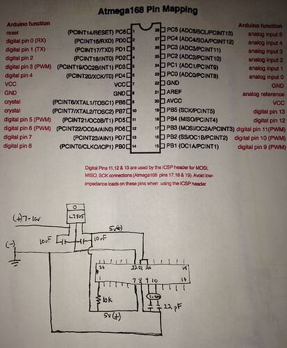

It didn't have a wiring schematic, so I came up with this:
Here is my voltage Regulator:
LM78L05
2x 10uF Caps, one input, one output
10K resistor on reset pin
22pF caps on the 16MHz Crystal
0.1uF cap on power pins (100nF = 0.1uF, this the decoupling cap you were referring to?)
White, Orange, Green, Blue jumpers on left side goto 6 pin header for USB2SERIAL adapter. 0.1uF cap on between reset.
(see below image)
The same test on an Arduino Uno?
You mean put it on the development Uno board rather than the breadboard?
I ment using the same sketch on a Arduino Uno.
The 100nF = 0.1uF = decoupling for the power when placed at 5V and GND.
You also need 100nF decoupling at the 78L05, on the input and output to GND.
You have Aref connected to something. That is not okay. It should be connected only to a 100nF.
5V at both VCC and AVcc.
Both GND to GND
100nF to Aref and GND, but that is only to reduce some noise. As a start, don't connect anything to Aref.

Yes, I did use that tutorial. How is it shorting the AREF to ground?
Imgur: The magic of the Internet
Do not connect pin 21 to 5V. Until you have a firm grasp of the Analog Reference options, never connect pin 21 to 5V. For the majority of Arduino work you do you will never connect pin 21 to 5V.
All the rest of the circuit looks good.

From your suggestions, I see that I might should use more 0.1uF/100nF caps. Here is a schematic of what I'm using.
I got the 47uF and 100uF ratings from Adafruit.
Would this be a good capacitor configuration to start off with as like a base breadboard setup?
Looks good to me.

Coming off my bench power supply is very stable. However after going through the LM78L05 it was jumping all over the place.
Added another 10uF capacitor in the power rail, but didn't seem to stabilize it.
The way I stabilized it was to double up the jumper wires. They just don't feel like they are making a "tight" connection to the breadboard like the components are. Plus they are cheap jumpers from eBay China. So highly doubt they are good copper wires inside.
After adding more jumpers to give multiple paths to supply power to the processor, it was much more stable on the output side of the LM78L05. This gave a solid stable reading on the bandgap measurement.
Some of my connections are good Belden 23 awg cat6 wires I stripped out to make breadboard jumpers. (U shaped flat style)
Then some others that either are long lengths or where I was going to move around a lot would be these type:
