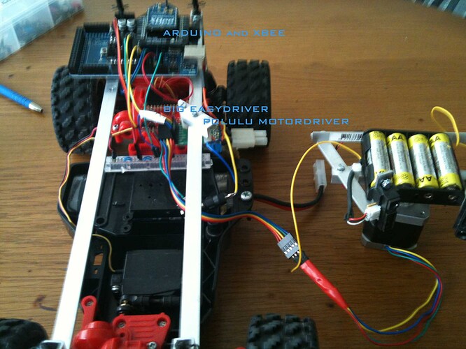

I have a picture to get a better view of the racecar:
1 arduino and xbee in the car to receive

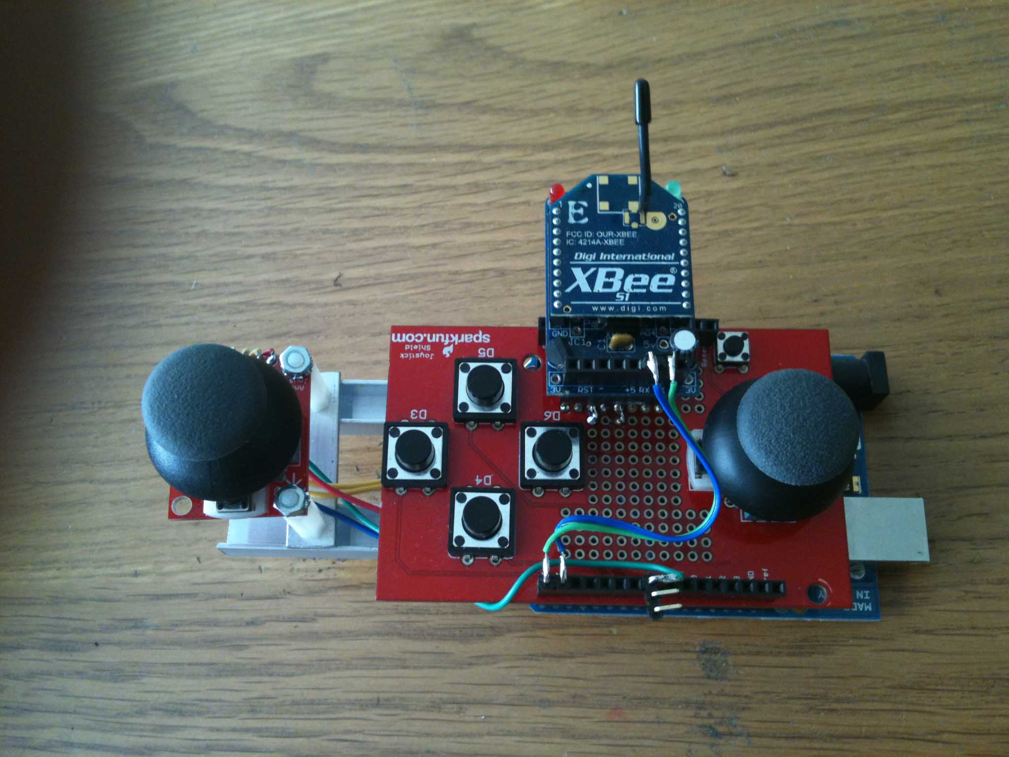

1 arduino and xbee in the remote control with a joystick schield to send

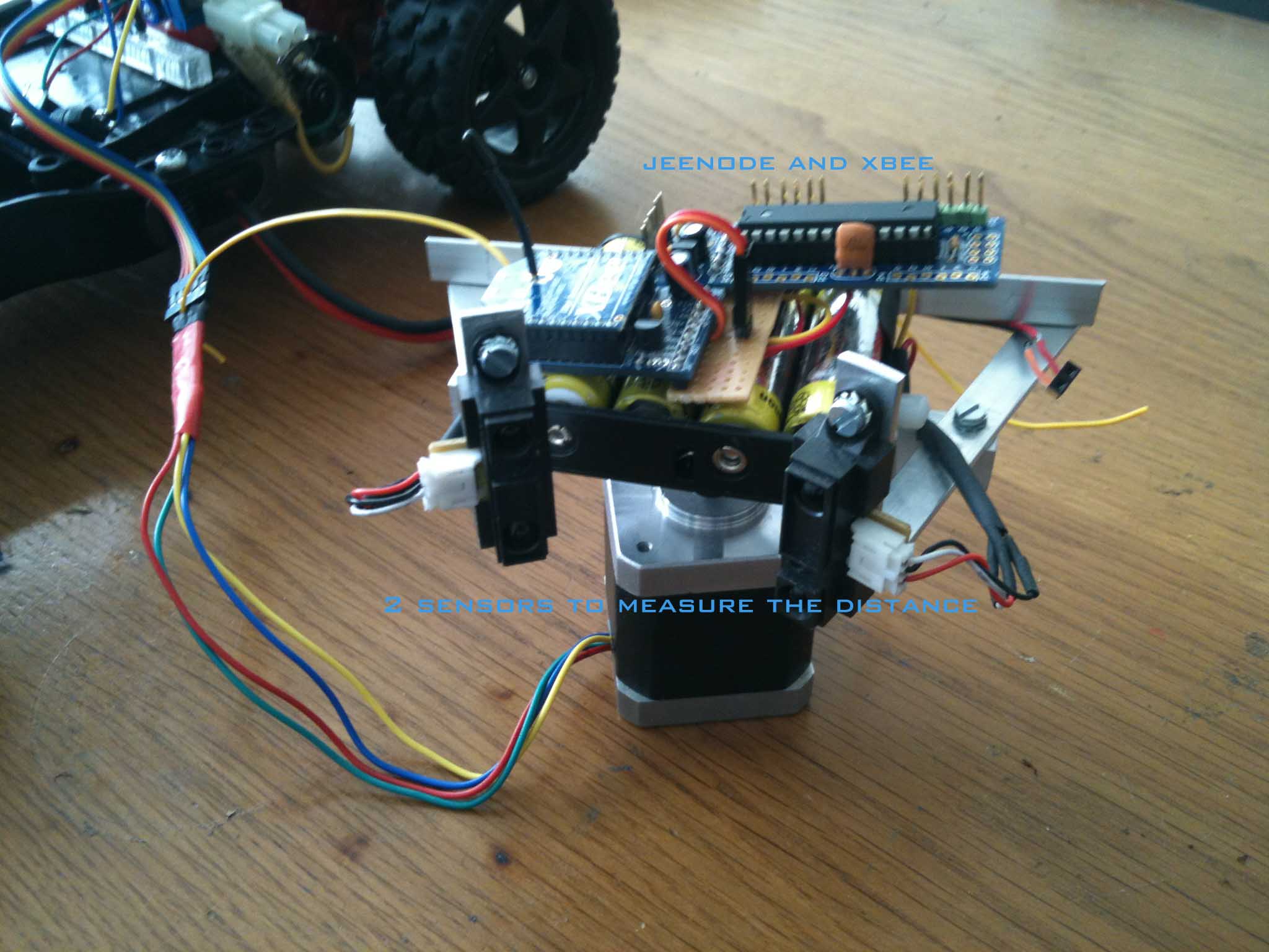

1 arduino/jeenode/xbee
to be on top of the car/stepper reading a analogue sensors and powering the water kanon
The easydriver is conected to the arduino pins
