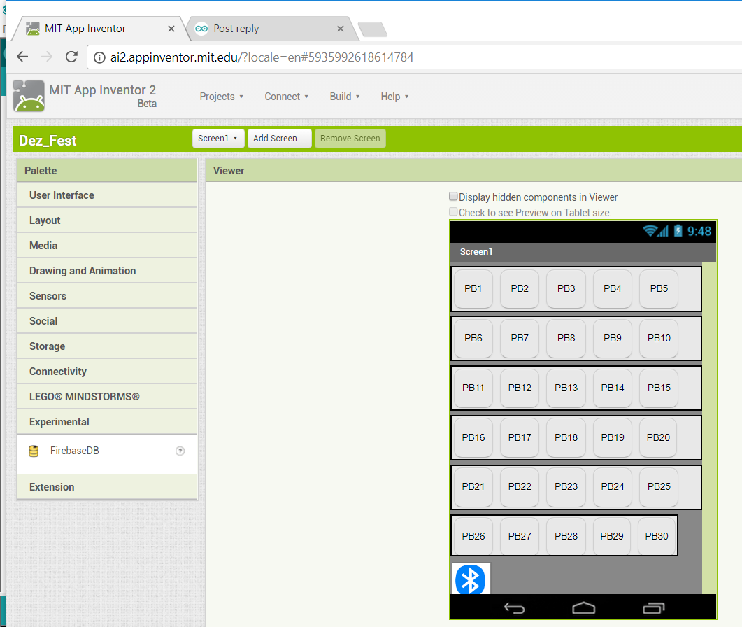

Hi all, I am new to Arduino world. I have been playing with 2 Mega 2560's and 2 HC-05's and (6) 16 Channel relay boards.
My plan is to use my android Galaxy s7 edge to trigger each relay to provide 12v to firework igniter. I am going to use ALL digital pins on the megas as outputs.

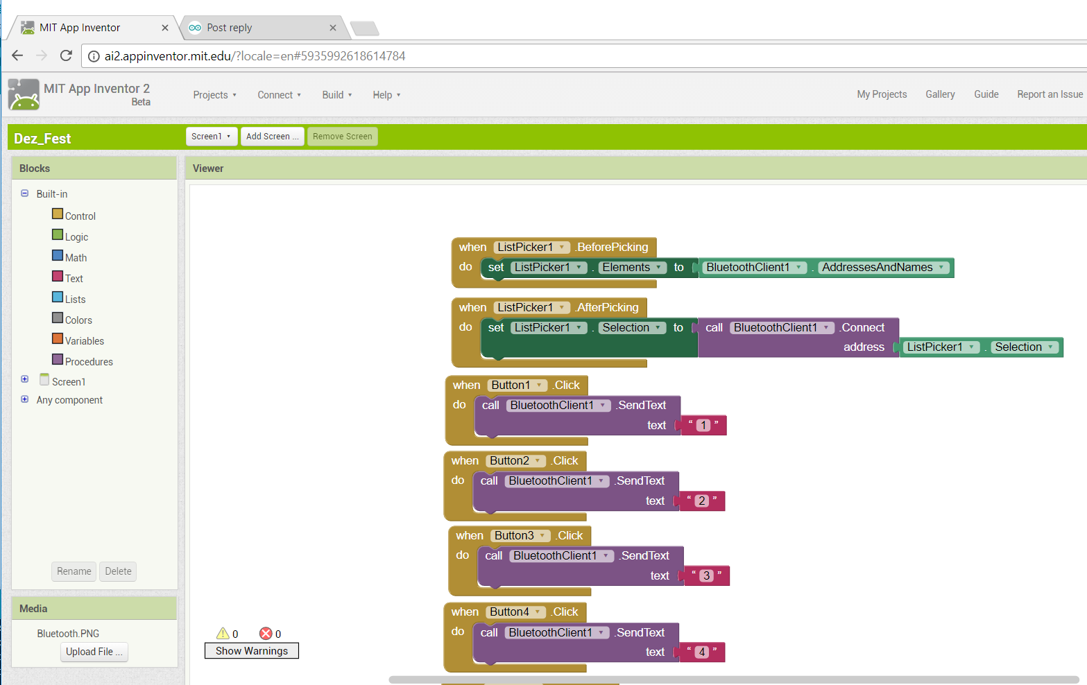

Currently using MIT App Maker 2, I have successfully connected to HC-05 and turned on and off 2 leds. (training/understanding software)
I want to link every digital pin on the megas to a PB on smartphone app. What I am running in to is the app sends the text "1" and the relay closes but doesn't reopen after PB pressed. I would assume there is still a "1" in the register.
I have tried the Click and Touch Down block in the MIT app maker.
Could I have some code move a zero into the register at the end of IF statement?
I'm sure there might be a better setup with different devices, but this is what I am working with at moment.

If you can write a phone app, you can write an Arduino sketch (program). :wink: But, if you are using "App Maker" without knowing how to program, you may find it more difficult.
Yes. By using an if-statement and a delay() or some other timing, and a variable to "remember" if the relay was triggered, the Arduino can turn-off the relay after a short delay, and then you can ignore the fact that you've sent a "1", and you can ignore any further 1's to that relay (until the system is reset, etc.).
