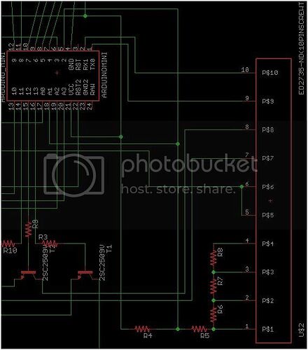

So... I should start by describing the part of my circuit involved by the question.
I have a +5v source connected to A1 and digital 2 (interrupt). I have connected both through a voltage divider so that the voltage sensed at both pins will change from +5v while no buttons are pressed, to anywhere below that when a particular button was pressed (buttons ground out PS1 - PS4 on the terminal block). See below.
I have created an ISR that is "falling" triggered. here is the main code. Obviously I am missing something about this and I have been trying very hard to solve it on my own.
The objective is to have TWO counters set up using 3 buttons:
counter one is "buttonCount' and uses 2 buttons, one to increase and one to decrease.
counter two is "idleCount" and it is only going to be 1 or 0 so I just use ++ and code to go back to zero.

The first counter, "buttonCount", works, it increments up and down. The second one "idleCount" will not.
This is trying switch/ case, and I tried a bunch of if statements previously,
(ie: "if (analogRead(A1) > 800) && (analogRead(A1) < 850) buttonCount++;)
but had similar results, I can get the first counter to increment but not the second.
So then I tried to make a simple code to test the switch/ case setup, incase I screwed it up so I wrote simple code with the switch/ case set up out of my ISR and it works just fine, increments both counters perfectly. So the issue seems to be with how I have designed the ISR.....
Can anyone help me?

If I understand correctly, though, you have a variable voltage being applied to the analog pin. You want to measure that voltage when it triggers an interrupt. In order for that variable voltage to trigger a falling interrupt, the voltage needs to drop below 60% of VREF (typically 5V, dropping to about 3.0V). The interrupt is not triggered as soon as the voltage begins to drop.
The use of an ISR in this case is not really feasible.

There is the piece of info I was lacking.... I even designed (and had manufactured) a circuit board around my flawed understanding of interrupts.
However, couldn't I just adjust the resistor values in the divider so that depending on what button was pressed the result was always lower than 3v ??? Then it would work fine wouldnt it???
I will however try as you suggested, without the ISR all together. But to be clear, when you say "polling is plenty fast", by polling you just mean when the loop goes over that particular line of code, looking for a change right? So the speed of the "polling" is completely dependant on the speed of the entire loop? This code is also running a PID and LCD library so I hope that doesn't bog it down too much.
Thanks again!
3 - I think (not entirely sure) the way you've got the circuit wired, there will be some voltage leakage out the interrupt pin. This will make the voltage at the analog pin different from what you expect. So even with different resistor values, it's not going to act like you want.
Fortunately, you are not the first person to hook up multiple buttons to an analog pin. You can search the forum for similar topics and get lots of advice about how to do that. There is even some code in the playground Arduino Playground - HomePage that might be of some help. It may not be usable as-is, but you can certainly copy pieces and ideas from it.

3- The interrupt pin won't leak "volage", it will leak a microscopic amount of current. This will have a minute impact on the volage read at the divider but it would be almost immesasurable at that current level.
To combat this you just need to create the circuit and test it with analogRead, then you know the corrected values for exactly what you are using.
The volage divider and buttons already work perfectly outside of the ISR for the counters, so there is no issue here.
Thank you for your help!

As for the divider working for the "falling" interrupt.....
In the circuit diagram I posted earlier if R4 = 1k, R5 = 250, R6 = 666, R7 = 1.5k,
Then:
no button = 5v
button PS1 = 1v
button PS2 = 2v
button PS3 = 3v
I know the values of resistor are not standard, you could just pick the nearest standard value and compensate in the code.
In the diagram the resistors are in series and cumulative, meaning that when you hit PS3, current flows through R5, R6, and R7 to ground. That means that the actual resistor in the R7 position would be 584 ohms, but the cumulative resistance would be 1.5k.
EDITED to make sense.
