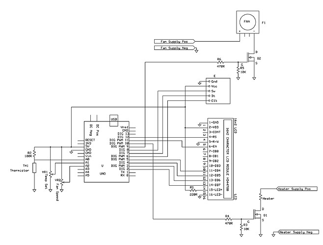

Hi everyone!
I'm doing my first project ever with Arduino (or with any programming involved at all) which is to create a 3D printer module for a CNC Mill.
The only electronic stuff I need is simple: control the temperature of the nozzle and the speed of a DC fan.
What I wanted is for it to be independant of a PC while operating, so I'd use an LCD display to show the set temperature and the actual temperature and a rotary encoder to change the set temperature. As for the fan just a simple potentiometer to change the speed.
I've done a little bit of research (I wanted to do more but I don't have much time), joined a bunch of circuits I've seen online and created the circuit attached. The problem now is that I've absolutely no idea if it's correct (it probably isn't). Could you guys please shed some light and inform me of how I could do this better?

Please just make a simple pencil drawing showing all the connections clearly labelled and post a photo of the drawiing. It will be much easier to follow than your attractive picture.
Also post your Arduino program.
If you are new to Arduinos I suggest you take everything out of the project except the Arduino and the heater components and just show the data on the Arduino Serial Monitor. Start as simple as possible.
How do you propose that the Arduino will detect the temperature?
Do you have the means to measure the temperature independently to verify the Arduino data?
...R

And that's why we don't like F**ing. Your 12V battery looks a lot like a 9V one. But putting the label on it helps.
What is the knob-like component in the fan's positive line? Motors work really well with MOSFETs. Use another MOSFET to control the fan speed.
Please try to use the schematic view in F**ing. It actually does a good job.
If you squint your eyes you might see a thermistor (100k) on the middle of the breadboard. That's a standard thermistor that comes with nozzles

MorganS:
Sorry, that's the potentiometer. I've seen somewhere that is how you connect them. Not sure I trust it though. And thank you for the tip.
I think I should have really made a simpler schematic...

Alas, can you see something wrong with the wiring on my mess of a circuit? Something obvious that really doesn't look right?

What fan are you going to use?
Check the spec on the MOSFET, it needs to be logic level type N-CH MOSFET.

This schematic may help, its just a suggestion.
You have two potentiometers, one to set your temperature, the other to control your fan speed,
Please check the spec on the MOSFET, it needs to be logic level type N-CH MOSFET.
Your fan need to be PWM controlled like the Heater.
What resistance and power or voltage/current is it rated at?
Tom... :slight_smile:

TomGeorge:
Wow Tom, that seems like it's just what I need! Thanks a ton, mate.
The fan is rated at 12V and 0.08A, so it's 0.96W and 150 Oms, by my calculations.
One question, Tom, if you please. If a potentiometer is setting the temperature, what is the encoder for? (the one right above the LCD)

gian_nichele:
Thanks again,
Gian
Okay, take one pot out and use the encoder to set temp.

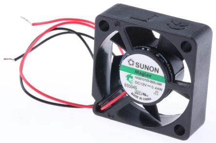

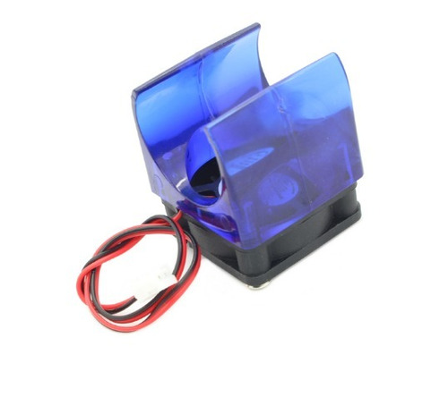

Is the fan EXACTLY like that or is that a photo of another fan?
The reason is that modern brushless fans behave very poorly when given PWM power. They always attempt to run at full speed until there's not enough energy to keep going at that speed. Then they stop. No proportional control at all.
It's useless looking up the part number in the photo if it's only "like" the one you have.
MorganS:
Ah I see it. Well, this is the one I'm actually gonna use
I can't see what model it is though, as it hasn't arrived yet and this is the only picture. It says it's for 3D printers though, so I'm hopeful. If all fails I guess I can always just plug it directly to power supply with an on/off switch.
Thank you Morgan,
Gian
