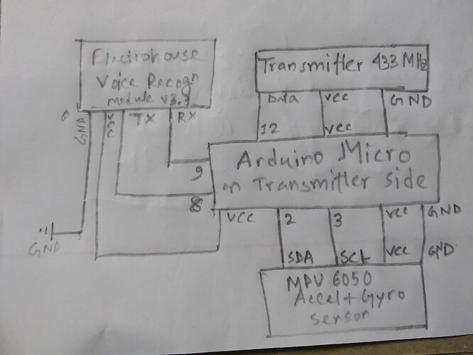

For my head mouse project which is based on the voice recognition module V3.1 for left click, double click, right-click operations, I am facing a problem. I am using 433Mhz Radio Frequency one-way Transceiver for sending data. When I use the MPU 6050 accelerometer and gyroscope for mouse cursor movement and the voice recognition module together on only one Arduino board, the mouse cursor moves smoothly and the voice commands work smoothly. But when I use the 433Mhz RF one-way transmitter for one Arduino board to calculate the mouse movement and figure out the voice command to send it in a wireless manner and receive the values and voice commands using the receiver module of the rf433 Mhz, the mouse cursor starts to lag. It doesn't move smoothly. Please help me solve the problem. The code and circuit diagram are given below:

Please post your code.
I've attached the code and the image to the post with the views as requested. Now, please help me out here.
